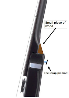

    Careful about taking anything out of the neck - the neck and pocket are designed to work with the bridge and get the right angle for the strings. Some kits are designed to have the fretboard slightly above the body.
    I grabbed this random image off the www - seems that standard Flying V fretboards sit off the body?

    Turned it on today and Im getting better volume, so looking good. Ok could be the fretboard sits a little above the body in case someone wants to fit a pickguard in there.
