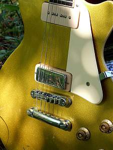

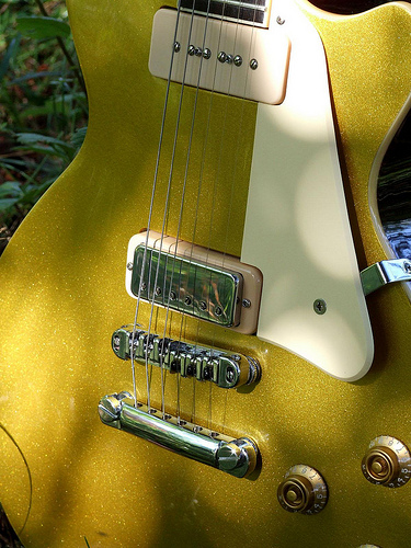

    Of course, Gibson's mini-humbuckers were designed to fit into P-90 routs by using a soapbar P-90 cover as the pickup surround!
