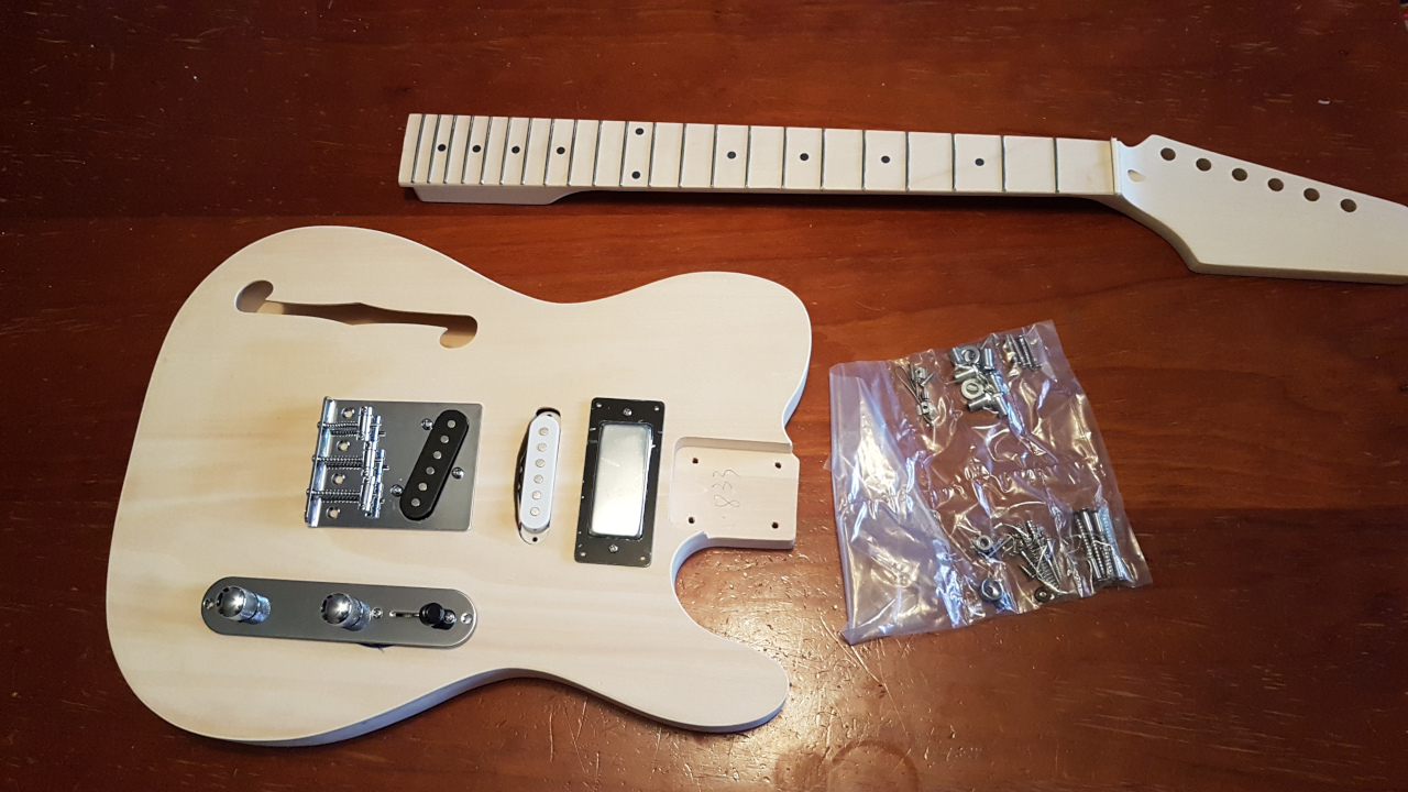

    I just received my kit and I'm excited.
    I own five guitars, but only one is electric, a Fender Strat.
    I've been wanting a TL, but I was intrigued when I saw this video:
    https://www.dropbox.com/s/h7mp0c4d64...390PX.mp4?dl=0
    The wonderful folks at PittBull were able to create a kit like it.
    I plan to do a very light stain to bring out the grain, but I want to keep it very light in colour. Any advice is welcome.
    The plan is to do a wood seal, stain and poly coat. I'm a bit worried about the fretboard doing a seal, stain, coat without messing up the frets. I'll have to read more about that...
    I have a few questions for the group; which I will post in following messages.
    Thanks!

    Maybe just tru-oil it. That will give it a slight yellow tinge. It looks like it is probably basswood, so there is less need to grain fill. you made need to stain it if the want the pop the grain.
  9. #7
    Quote Originally Posted by jgraves View Post
    Tru Oil is probably the easiest way to go as it seals and finishes all in one. I have also used it on maple fret boards too, just need to use 0000 steel wool to polish it off the frets once fret board has been done and final polished with car polish products.
