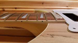

    Well it took a little longer than I thought, but it has worked out splendidly. It tunes, it is intonated almost perfectly, the action still needs minor work, but I have bought new name guitars in a much worse state! It plays very well, has an excellent sound and looks really wild.
    I actually completed the build last November in 2017, however it has taken a while to get round to documenting this. Far too busy playing it...
    You can see it didn't retain the original top that it came with, this was a shame, sadly, and despite warnings from many people on this forum, I sanded straight through it! Oh how we laughed!

    That is a very interesting combo. Good work!
    That is wild mate, nice job! What is the top made from?
    London
    33
    The top is "spalted Maple". It has an almost psychedelic pattern, it's only got a few coats of Crimson Guitar finishing oil.
