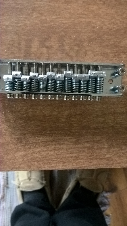

    I started the kit knowing I was going to dump a load of cash on components. By the time I started wrapping it up, I began to sicken of it. Yea, the Rickenbacker bridge plate with two screws initially was just right when I set it up the first time. But, I didn't align it from left to right to cover the fret board evenly. After a modification, it was aligned, but offset. I believe that's what your referring to. Hey, it the melee of spending I bought 2 of the bridge plates, so I'm still in business. Thanks for checking it out.
    Bill, Simon is referring to the fact that 12 strings are usually six pairs of strings with a larger gap in between each pair. Like this
    I can imagine it would be a bit tougher to play with all the strings spaced evenly. You've done a lovely job of it though. It looks great.
    The nut was in the kit. That's the way it wants it. I notched the bridge myself, but I stuck to centering each notch. Tell you what. I'm going to see if I can buy a different nut with that sweet acoustic spacing. I'd like that more. Thanks.
    That's the standard way for electric guitars as well. Have you got pictures of the nut and the bridge (without the cover) showing the notches? You'll almost certainly need to re-notch the saddles, or maybe even replace them, in order to get the correct string spacing. The nut may be fine if it came with the kit.

    The very first thing I noticed when I plugged it in was that 5.8 ohm neck pickup. I loved it. But the DIY honeymoon couldn't make it through the 'action'. I wasn't able to make a chord past the third fret. You, sir, are quite correct about the 'spread' and the saddle/nut. I ordered a Rickenbacker 12 string nut last night, and I'm seriously contemplating re-nothing the bridge. I'll get you a picture. Thank you for the input. It's very helpful
