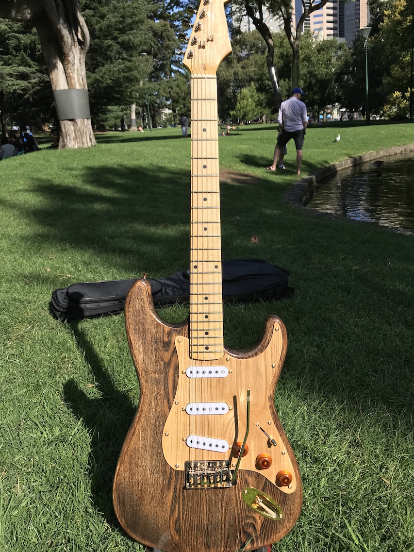

    Hey guys, first time posting - hope you'll enjoy!
    Here is my 3rd Pitbull build, after my Les Paul Junior and my SG3 (a nice lesson in routing). With a working name of "Morning Wood", "Treebeard", "Sherwood Forest", "Woody" or "Victor Wooden".
    It all started with the STA-1M Ash Stratocaster - the grain looks great, and I have a hard time justifying a rosewood or ebony fingerboard on a Strat. Immature and reductive, I know. But maple fingerboards just seem right.
    Body
    - Phase 1: 220/320 sand down the body and applied Feast Watson Black Prooftint stain. Then sanded the entire thing off. I read somewhere that this improves the contrast of the grain. I can't cite it and I have brought shame to my name. Sorry.
    - Phase 2: Coat of Feast Watson Sanding Sealer, and then a 320 sand. Done twice for optimum smoothness.
    - Phase 3: Cabott's Walnut Water-Based Interior Stain
    - Phase 4: Two coats of Tru Oil and then smoothed it out with 00 steel wool. Repeated this process for a total of 4 times - so 8 coats of Tru Oil.
    - Phase 5: Two coats of Howard's Feed-N-Wax. Smells great and makes for a great finisher on a body
    Neck
    I straightened the neck and levelled out the frets by using the tips from Guns and Guitars' amazing video Make pro guitar luthier tools out of stuff you have - it was the most boring part of the build, but it DEFINITELY made a difference on the finished product.
    I pretty much copied Ben Eller's method for re-finishing necks; while adding a Feast Watson Golden Teak Prooftint stain.
    Two coats of Tru Oil, smoothed out with 0000 steel wool, done twice for a total of 4 coats. And then two coats of Birchwood Casey Gun Stock Wax. I love the feel of the grain of the neck and the satin smoothness of the Tru Oil. Can't recommend this stuff enough!
    Hardware
    - Amber knobs
    - Ash pickguard and backplate
    - Gold pickup selector switch
    All from eBay. Everything else was stock - including the missing screw for the bridge, which Adam quickly sent over for free after I contacted him.
    Pickups
    Guitar Fetish Premium II Strat set w/ Kwikplug harness - 250k pots and a .047uf tone cap
    This was so incredibly simple to install. Sweet Strat tone, without the wiring headache.
    Anyway, hope you guys enjoy the photos!

    A very cool look with the timber scratch plate and covers, how does it sound.

    Quote Originally Posted by Wayne.Mumford View Post
    Cheers mate!
    GFS market the pickup as sounding like Mark Knopfler, and I tried to see what all the fuss was about. When I was setting the guitar up, the closest amp was my Gallien Krueger 400rb - a bass amp. Figuring I'd just plug it in and have a go, it blew me away! I had a jam over Sultans of Swing (because how much more of a casual fan can you be?) and it fit in perfectly in 4th position. Plugged into my Thunderverb and I couldn't fault it, though I'm more of a fan of an HB in the bridge. GFS pickups are proving to be an up-and-coming favourite of mine, mainly due to their ease of installation, as well as the price...and I guess it helps that they sound great

    Yeah, that pickguard looks great
