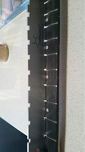

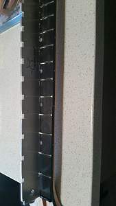

Name:	2017-12-06 17.43.14.jpg
ID:	23634Click image for larger version.
Name:	2017-12-06 17.44.08.jpg
    I straightened the neck and checked again though still didn't make much difference. Hard to see from the photos.
    I also checked on an old greg bennett interceptor which is supposed to be 25.5" and it didn't line up now I'm doubting the straight rule.
    I'll do those measurements now Wokka, thanks mate.
    I think you might find that first notch is designed to sit over the first fret, rather than over the nut. That seems to be how it works with the stew mac version I have, or else i have a similar dud rule.
    BW one of the pics looks like the frets are sitting in the slots ok and it's touching the fingerboard.
    Maybe check the fret ruler on another guitar to check the ruler is ok.
    Once we establish the scale length we can check the fret distances using the link below
    https://www.stewmac.com/FretCalculator
