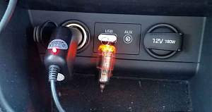

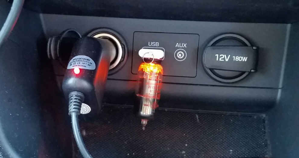

    I've actually been making some "steampunk" USB flash drives. with a valve glued onto it and an orange LED underneath to simulate the valve heater. That way I can enjoy all the warmth and brilliance of the classic valve sound while playing MP3 files on mycar's sound system. (Or so I tell people....)
    It's a sensible alternative to fitting a valve amplifier into the dash of your car, which is sure to be inconvenient and will probably void the car's warranty! (The orange LED glow tends to overload the camera; it actually looks a lot more realistic "in the flesh").
