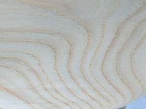

    Grain Filling
    Hi Wazkelly,
    Any suggestions on best TimberMate colour to match the natural Ash grain colouring ?
    (Further to your earlier/previous suggestion I tried some Ebony Timber Mate on a sample piece of Ash timber and found it yielded a blue-black tinge. This might have been okay under a tinted finish but I'm now looking to use DT Nullarbor Ochre - pale red-brown with satin finish.)Click image for larger version.
