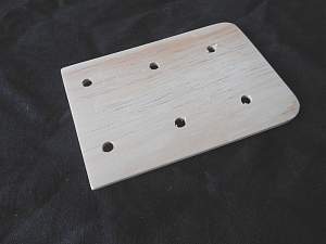

    I need to do a full pocket shim on a 5 string bass neck due to the heel being convex and loosing about 1.7 mm in height in the process of making it flat. I understand a thin piece of maple is best practice for this, but in your opinion are there alternatives that offer the same sonic value? Metal perhaps? I'm finding it hard to obtain a blank piece of maple of the thickness and size (75 X 105 mm) I need for the 6 bolt neck pocket.

    I de-laminated some good quality marine ply to make a shim on my Jazzmaster.( used 1 ply) Once glued in and painted you would never know it was there.
    I like that idea... did you need to do anything to the ply to assist in the delamination?
    I pretty much cut it rough size at full thickness then used a coping saw to cut a slice off at the right thickness
    Well the Dedman Method® gets my nod of approval. Only took 10 minutes and cost zilch.
