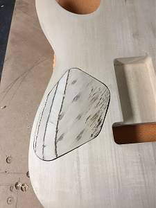

    I've had to make a new board for it, rout some additional channels for the cavity cover (I made this magnetically attached) and re rout to get a land to secure the locking nut for the output deep panel jack.

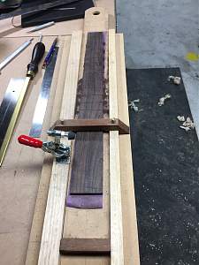

ID:	19997 Fretty, fretty, SLotty Slotty

ID:	19993 New fretboard in place, slotted and radiused, Scale length issue sorted.

ID:	19998 Cover rout, with carved Ply cover (I Might just make paint that black)

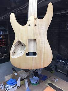

ID:	20001 It also has some lovely grain patter on the rear, I have elected not to put a cover over the trem cavity to help keep the nice clean lines to it, though i think I will probably spray this black. Earth will be to the trem post via the post hole.

    I've stripped the board cleaned up the end of the Neck heel and got it fitting right. the new board is a dark rosewood (a PBG Blank i got from Adam) and it has had to be reconfigured to 22 frets.
    I'm happy to say that I've slotted it, attached it, radiused it and created the locking nut seat at the top and the thing measures dead on for a 648mm scale length now, exactly 324mm at the 12th and ditto to the bridge.
