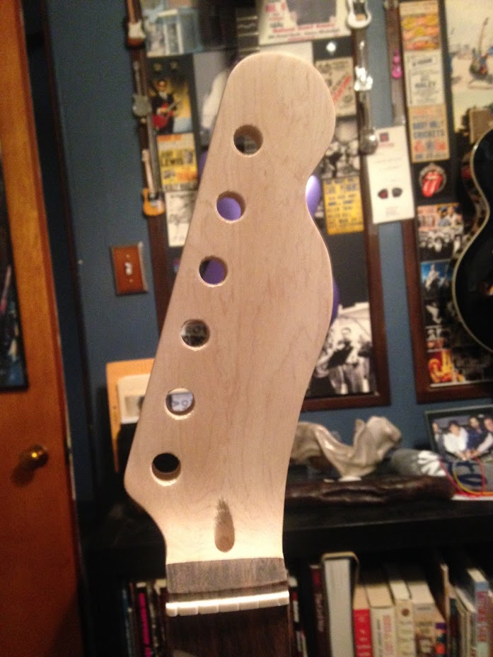

    Headstock work
Name:	headstock pre cut.JPG
    Pic of the headstock and template I used
Name:	headstock rough cut.JPG
    Rough cut of the headstock with a jigsaw
Name:	headstock rear pre shaping.JPG
    Rear of the headstock pre shaping, penciled in areas were removed and was squared off
Name:	headstock rear post shaping.JPG
    Rear of headstock post shaping
Name:	headstock front post shaping.JPG
    Front of headstock post shaping

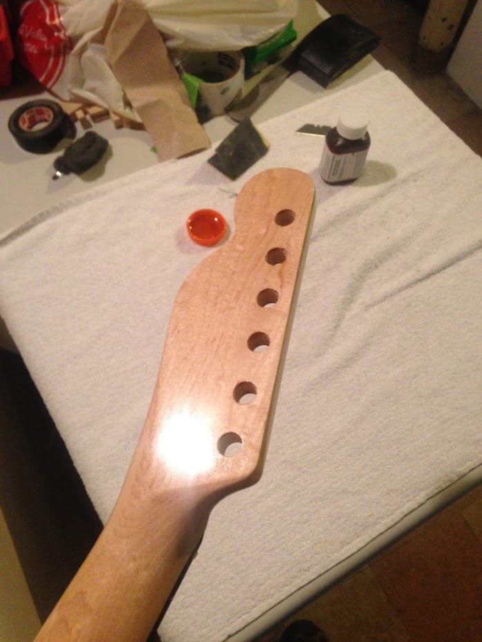

    Dec 2016
    Pittsburgh, Pennsylvania, USA
    43
Name:	headstock front 5 coats.JPG
    Front of headstock with 5 coats of truoil
Name:	Neck 5 coats.JPG
    Neck with 5 coats of truoil
Name:	headstock rear 5 coats.JPG
    rear of headstock with 5 coats of truoil
    sanded to 600 grit prior to application of truoil
    and 0000 grit steel wool between coats of truoil
