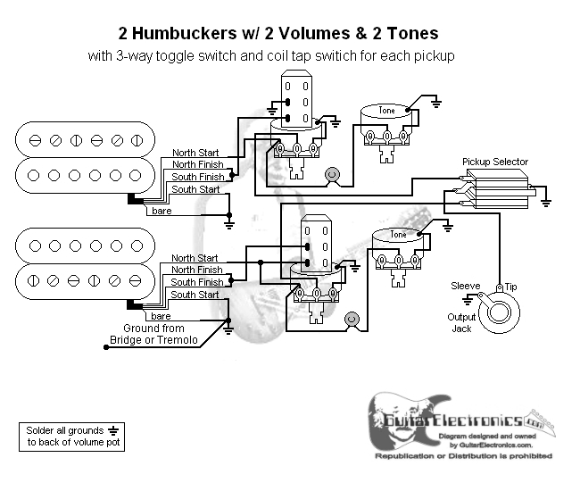

    H, I try to use shielded cable where I can , espeically on those long runs to switches on Gibsons.
    I used this diagram

    While I'm OK at following wiring diagrams and simpler schematics, my actual knowledge of electronics is kinda weak, so I'm gonna ask a potentially stupid question.
    Standard wiring has volume > tone and then tone > cap > ground. The diagram you posted has volume > cap > tone and then tone > ground.
    To my (weak) understanding, that looks like a slightly different way of doing the same thing (edit: As in, this is a resitor and capacitor in series and so the order shouldn't matter). Is there a reason to use one over the other? Something to do with placing the cap before or after the tone pot?
    That's a question for Weirdy, I can follow diagrams but like the internet I don't know how it works, I just accept that it does :P
    The order of capacitor and potentiometer resistance for the tone pot doesn't matter. The capacitor and the pickup's impedance make the actual RC low-pass tone circuit, the tone pot's resistance just varies the amount of low-pass signal that gets sent to ground.
    It is important for an RC (low pass) circuit that the resistor goes first and the capacitor is connected afterwards and down to ground. Do it the other way round, with a capacitor first and a resistor on the leg down to ground, and you get a CR (high-pass) circuit. But as previously mentioned, in a guitar tone circuit, the pickup is the 'R' component, whilst the capacitor is the leg down to ground and the pot is just a variable resistance in that ground leg.
    In reality it's less simple than that, as the pickup also has inductance and capacitance, and there's also the volume pot path down to ground as well. so you get a resonant low-pass filter, with a resonant peak at the filter's turndown point. Most humbuckers have higher resistance and inductance than single coils, which moves the low-pass turndown point to a lower frequency value than in a single coil. This is mainly why humbuckers have a lot more middle and far less high-end to them than most single coils - the resonant peak is boosting the mids, and the trebles are then quickly rolled off after the resonant peak (some of this is also due to phase boost/cancellation issues with the two coils sensing different parts of the vibrating string). On standard single coils (e.g. Strats and Teles), the lower resistance and inductance values move the resonant peak into the treble area, so they are less mid-sounding and can have very pronounced treble content.
    Of course, single coils with more powerful magnets and more windings such as P90s have a lower resonant peak than most Fender styles, so whilst being brighter than humbuckers, aren't as bright as a Strat or Tele pickup.
    With the large 'bumble-bee' paper-in-oil capacitors originally used by Gibson on Les Pauls etc. I'm assuming in physical location terms it made more sense for them to run the capacitors between the volume and tone pot than to try and fit them on the top of the tone pots and wire them between the tone pot and earth. Especially as they didn't have heat-shrink sleeving at that time and positioning the cap between the two pots helped avoid any inadvertent signal shorting.
