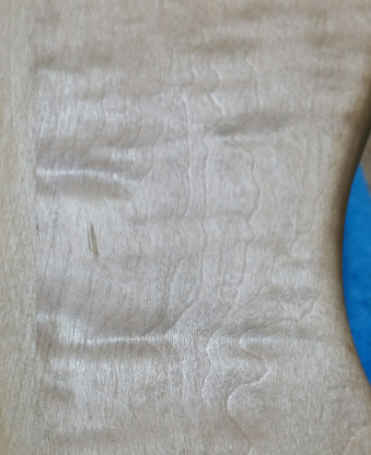

    OK, glue dried, dowels smoothed off; construction starts off tonight.
    I'm also experimenting with some Feast and Watson Fine Buffering Oil for the finish.
    I've used a lot of this stuff for restoring old furniture, and it gives first-class results; generally I strongly suspect the items never looked that good when they were brand new!
    You apply it with steel wool, and polish with a soft cloth. Although the recommendation is just 2 coats, I've found that the more layers you apply, the better it looks. It takes a couple of weeks to harden completely, but I've found if you just put on one layer every evening after work, the job gets done in no time. It looks sort of like very-well-applied satin lacquer, but there's not a trace of brushmarks or drips.
    This is the best I can do for a photo, which doesn't do the 3-D grain effect justice:
    (This has only 2 layers).
