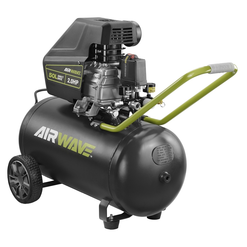

    you can usually pick up a small compressor on sale, the advantage being you can also use it to pump up tires, footballs ect, blowing dust away and so on. The small ones that run on 10 amp power wont run air tools however (unless you like working for 30 secs then waiting for it build up pressure again). Something like this should be under $200, they are sold under literally hundreds of brand names but 90% of them come from the same factory. I use one of these for both my spray guns and air brush. I've even painted furniture with it.

    I painted the car in my avatar with one of those compressors & a high quality HPLV gun, now have a much bigger belt drive compressor that can run air tools properly.
    If you are going to use a compressor make sure you have a good quality moisture trap in line and also loop the line from the trap to the gun up over the rafters so any water that gets past the trap has less chance of getting to the gun

    Hey MJG, as others have said if you have other uses for a spray gun (inside house etc) it's worth the outlay for a compressor and spray gun set. I picked up a similar compressor to the pic above on sale for $100 at Repco and a 2 spray gun set for under $100. You will get a far superior spray quality from this setup compared to the powered ones
