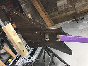

    If it has a side mounted jack you can rig like this, assuming you have the space and materials:Click image for larger version.

    The jack socket is front mounted on a small scratchplate.
