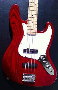

    I was thinking more along the lines of an ink and clear coat. Is that possible???
    Quote Originally Posted by Hobastard View Post

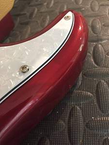

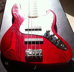

    Something like this perhaps???
ID:	17704Click image for larger version.

    This is the closest to what I want so far, but still a little Dark, that's why I thought some kind of Bleaching or lightening of the timber might help.
    The grain is perfect as long as I can get the base colour. Just a little lighter would be perfect. My other concern is that if I get it too light it might come out Pink.
    And we don't want that do we Fellas.....
