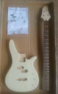

    Hi everyone,
    I've had this kit for awhile and I'm going to build this for my brother.
    One coat of timbermate has been applied a couple of months ago but not sanded off. I'm about to do that after a mock build.
    Again another bolt on kit missing holes in the neck heel. Their site says it's a 34" scale length with 24 frets.
    Do I use the same intonation guide here on this forum or is it completely different?

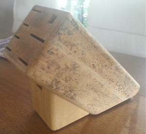

    Yes I'll keep doing more pictures. I also need to put together a video too for the other LP build. I have been testing stains and clear coats recently.
    Here is a test run I did with poly clear coat. Not a guitar but it was a test so it's related hahaha.

    Sort of related as it is timber and turned out to be a great test bed.
    That looks great and can't wait to see how you transfer this new skill on to your guitar builds.
    Do you want to come around and do my knife block too please?
    Thanks it was a good test run.
    Hahaha sure sounds good if the cold beers are flowing
    Hi everyone,
    Two problems pictured below.
    You can see I have filled the crack with timbermate but it still stands out. I was thinking of scraping the surface inside the gouge slightly so I can add a saw dust and superglue slurry?
    Also, the bridge drill holes are missing on this body. Is there are thread on here that shows how to accurately align the bridge on the body? The plate may even cover up the above timbermate fill depending on where it is placed.
