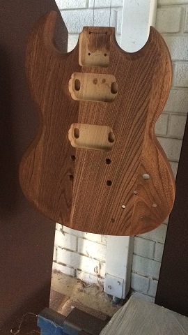

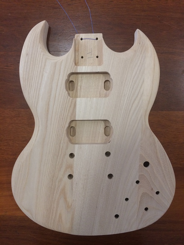

    Body Grain looking not too bad

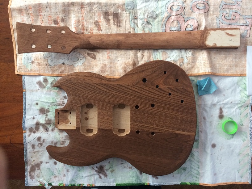

    This is it hanging after the first 2 coats of custom brown dingotone

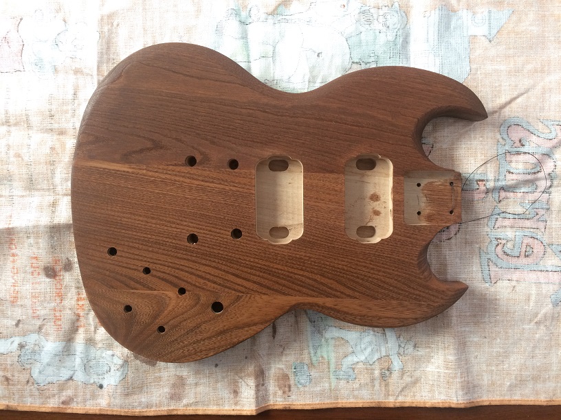

    The body after the first intensifying coat

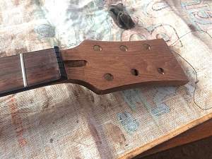

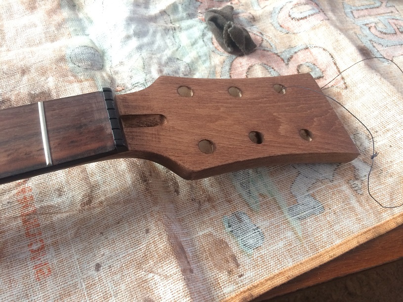

    This is the headstock after the first intensifying coat. As you can see i have gotten some of the stain on the fretboard!! Anyone any ideas of how to fix this? or should i just put a thin layer across the whole fretboard?

    Looking like some crazy good grain in that body. As for the stain on the fretboard - gently scrape the blade of a razor blade at 90 degrees to the wood. See Dingobass' post in here... http://www.buildyourownguitar.com.au...ght=razorblade - that may take it off. After that I'd tape up with some painter's tape to minimise any possible future mishaps.
    Edit - BTW - loving the colour.

    Thanks for the advance on the fretboard. I'll get scraping tomorrow!

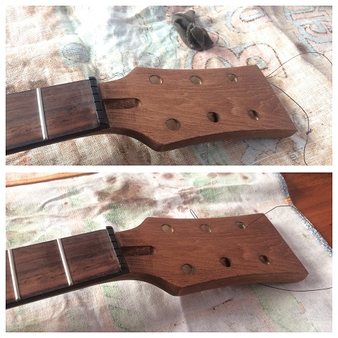

    Also thanks Brendan (and dingobass) for the advice to scrape the fretboard to get the stain off

    A before and after. I got enough off to please me but i was scared to over do it and dig into it too much...
    you can see a bit of difference between the first and second intensifying coats of dingotone on the headstock too.

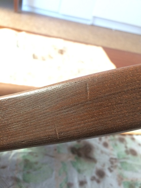

    These two dings magically appeared. not sure how they got there, i mustn't have noticed them at the start. not sure if anything can be done with them...gives the guitar character eh...

    I feel your paid, I dropped my ash Tele pretty badly after the intensifying coats ....it still has the love bite.

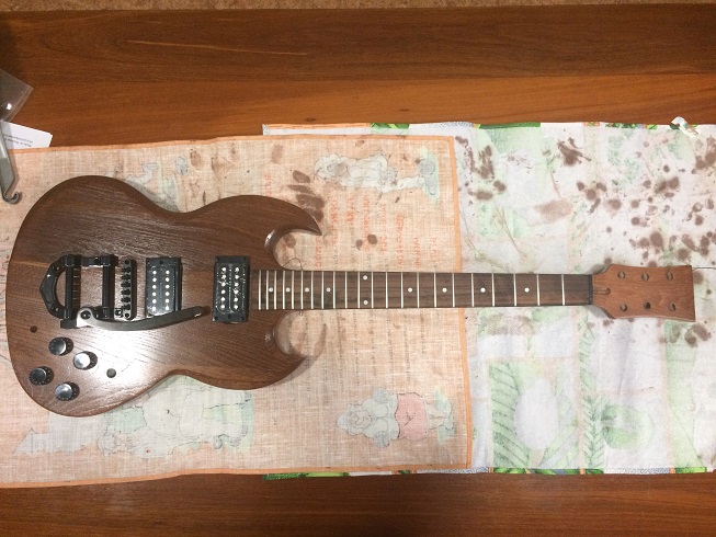

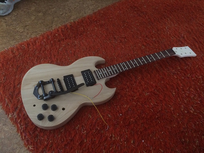

    Did a quick mock build before putting on the final coat. i am liking it so far. although fuzzbeard i think i may have to do something with a hole or 2 to make the trem align ok, but im not worrying about that just yet.

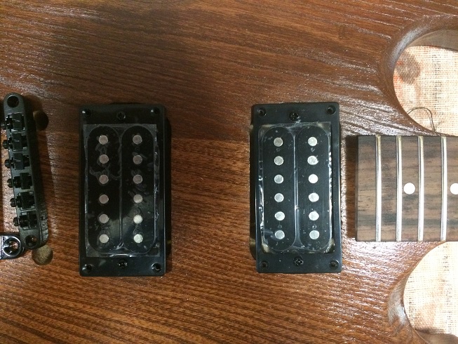

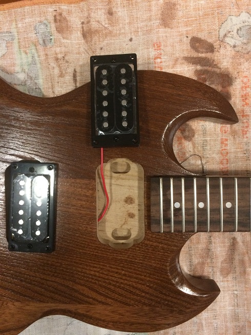

    more pressingly i have just seen that the pickups supplied dont fully fit the routhing. im not sure if you can se from the photos but there is a gap around the pick ups.
    Anyone any idea why? thanks in advance
