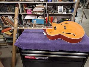

    Next, we bolted the neck on to check neck alignment.
    The neck was actually a tiny bit too big to fit in the pocket correctly, so some careful judicious sanding was needed. Also, there was a bit of...slag? in the pocket (wood bits in the corners that hadn't been routed out correctly), so a bit of time with a file was needed to clean that up. Once we were sure the neck was seating in place properly, we threw some clamps on it.

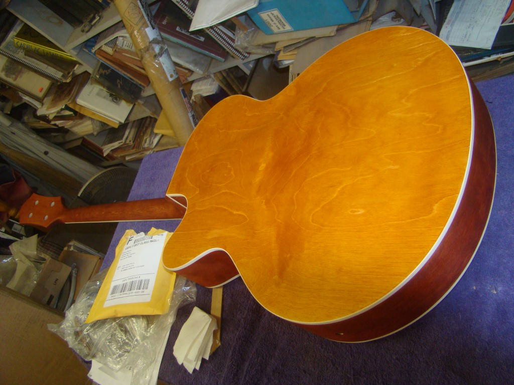

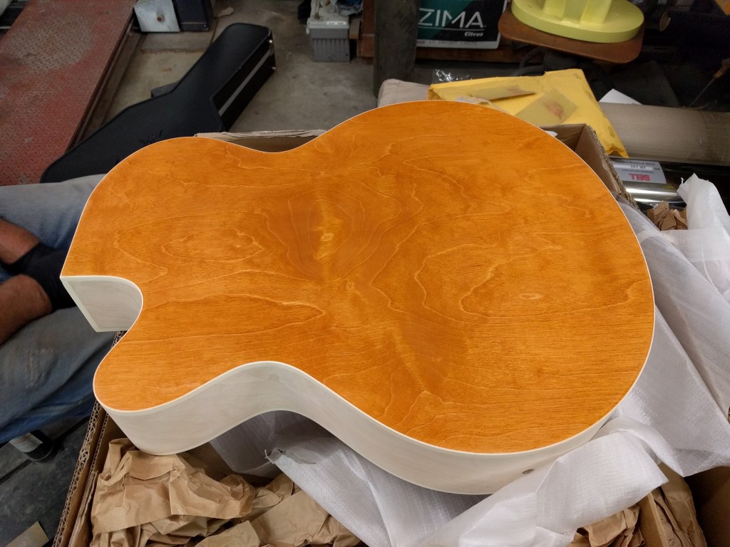

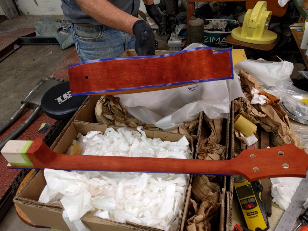

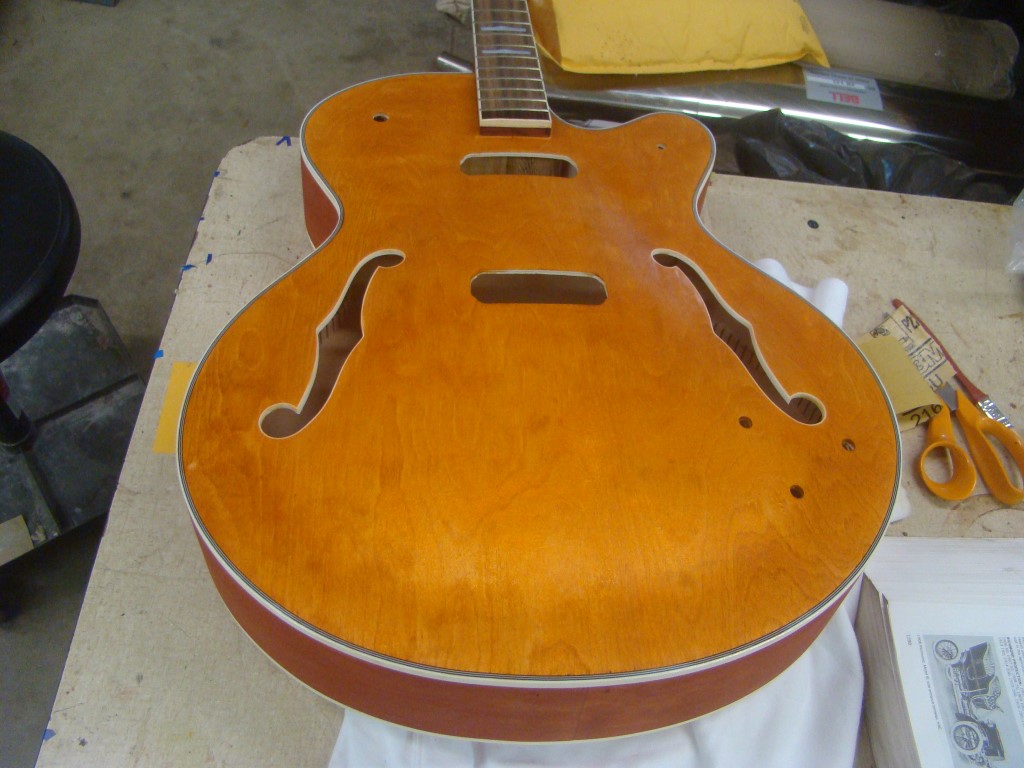

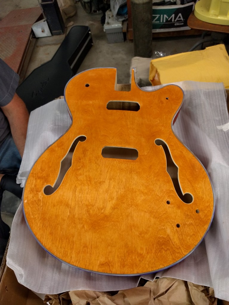

    Next we stained the body and neck, deciding that we'd do the staining while the guitar was still in two pieces, and then glue in the neck so the guitar could be finished as a single unit. We used Solar Lux dyes (because our friend had some on hand, and we'd read that they were good for this sort of thing), applying medium brown mahogany to the neck and the sides of the body, and golden fruitwood to the front and back. (We did the back, then let it dry thoroughly. Then did the neck and sides, letting them dry. Then we did the front.) The dyes looked great while they were wet, but ended up very "flat" looking when they dried.

    Stain application went well, with two small issues. There's a smudge on the back where we got some of the dark stain on the lighter back of the guitar, and there's a place near the neck pocket that must have had some glue in the wood. No matter how much we sanded, we couldn't get the glue out enough to get that spot to accept the dye the same way the rest of the guitar did. Ah well, we'll find a way to hide it.

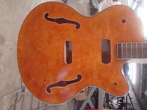

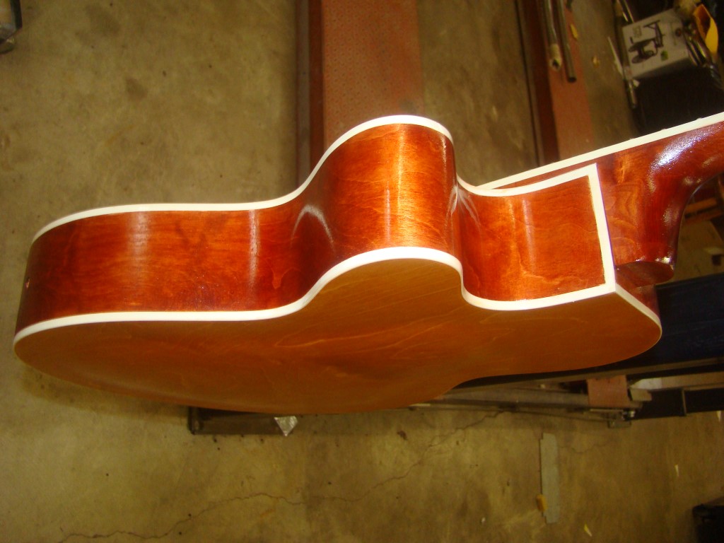

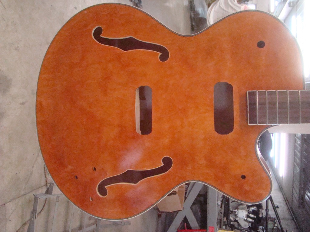

    Next step is to apply the finish. We've decided to go with Tru Oil, as we want a thick glossy finish, and lots of coats of Tru Oil seems to be a popular way to accomplish that. The color was very flat and plain looking after it dried, but luckily the very first coat of Tru Oil began to allow the grain and the beauty of the wood to show through.
Name:	DSC04981 (Medium).JPG
ID:	12311Click image for larger version.
Name:	DSC04982 (Medium).JPG

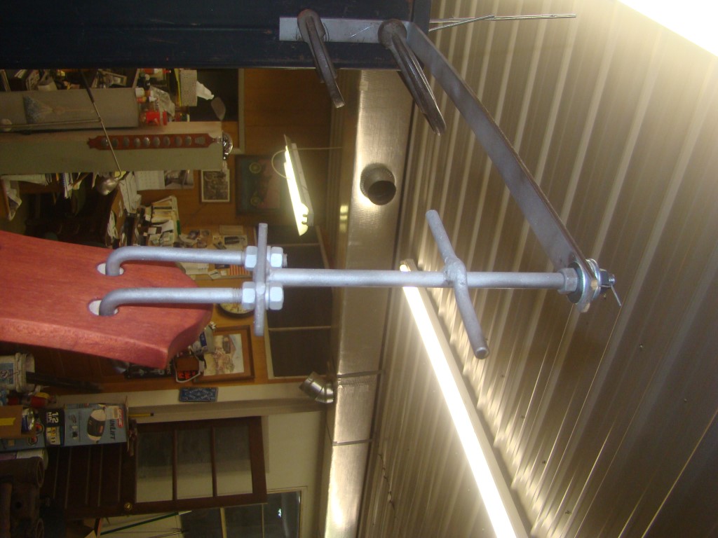

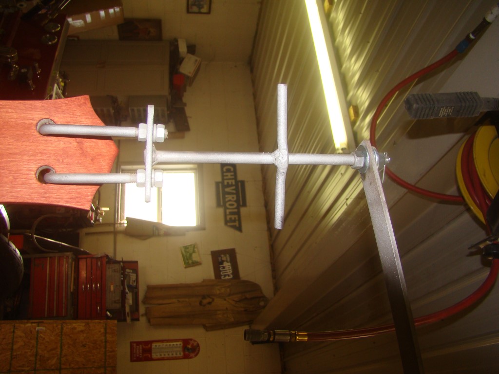

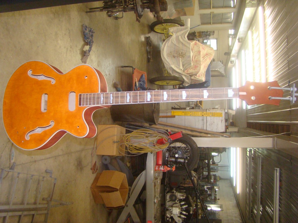

    I've been away from the shop, so my father built a rig to suspend the assembled guitar, to allow for putting oil on the entire thing at once. We didn't want to have to deal with doing the front, letting it dry, then doing the back--if we didn't have to.
    My father writes:
    "It became pretty evident after applying the first coat of TO to our bass that instead of waiting for either side to dry why not make something to suspend it and be able to apply a coat to the entire guitar.
    Construction was pretty simple. we took to short pieces of 5/16 rod, bent into a J and threaded the ends. Next was to drill a piece of bar stock to mount the hooks and a third to secure the center pin, this was threaded on one end the other welded into the bar holding the J hooks. You will also note at the top I drilled a hole for a pin, a safety measure just in case the nuts loosened enough to let the rod slip out and all come crashing to the floor, something I suspect would not happen till the very last coat was applied. and I added the "accessory" T bar for easy rotation while oiling. This will also work for a six-a-side headstock simply by making one hook longer to suspend using two holes.
    I attached my holder to a beam in the shop, other suggestions may be the end of a kitchen cabinet, drill some holes in the side of your refrigerator attaching with easily obtained sheet metal screws, this would allow easy and quick access to a beer(grog) while working, any door, even the shower but I'd caution that you may not be able to bathe while finishing your guitar. The options are endless, good luck."

    That suspension jig is fantastic! I love that you built a safety into it, really clever idea, which of course we will steal at the first opportunity.....YOINK!

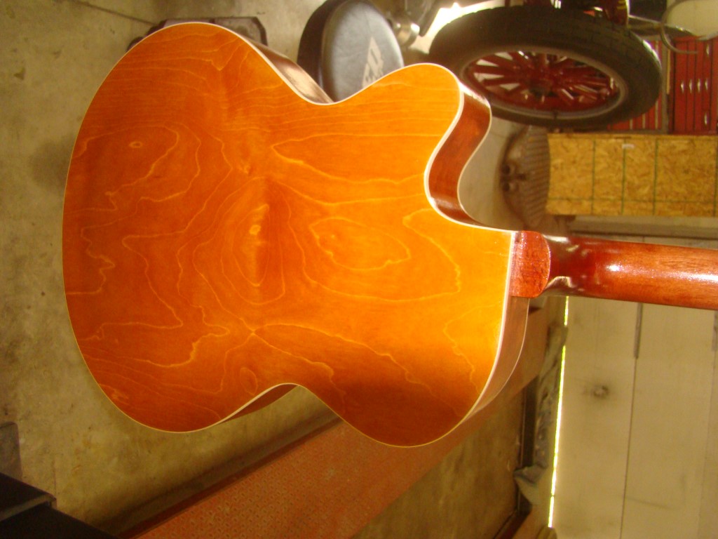

    Four coats of Tru Oil applied:
Name:	DSC04989 (Medium).JPG
Name:	DSC04990 (Medium).JPG
Name:	DSC04992 (Medium).JPG
