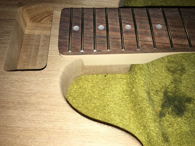

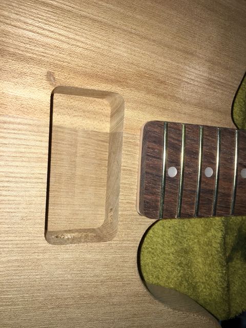

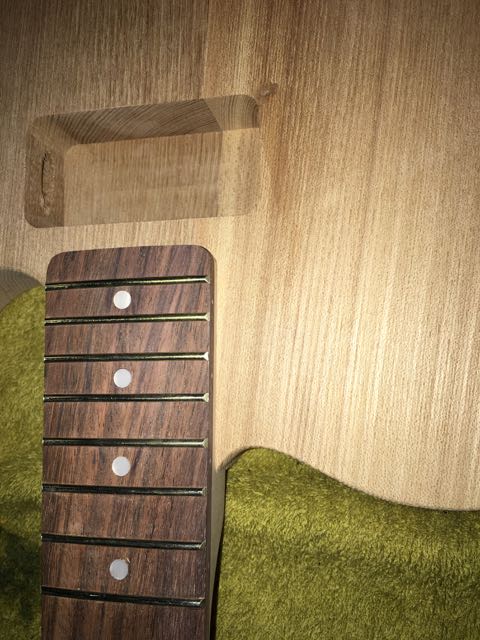

    There are a few corrections needed on close inspection. The bridge pickup route needs to be expanded to fit the Tonerider pick up and clear the cut out in the bridge.

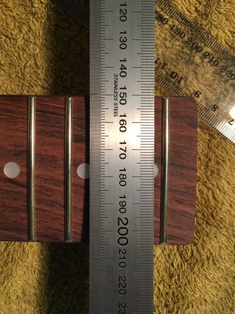

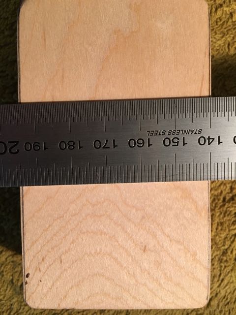

    The neck is also bigger than the pocket so I will need to chisel/file out a fraction on either side after finding the centre line of the guitar.

    May I suggest that it is better to remove a touch off both sides of the neck heel rather than attacking the pocket..
    Not only is it easier to do this you have less chance of taking too much off.

    Thank for the suggestion DB, I was thinking of doing this as well. So I will look at this first.The neck looks to be about 1.25 mm too wide. I was a little concerned about buggering up the frets, but it will be OK with sanding I guess.

    good stuff Marze, how much wider is the neck than the pocket ? maybe you can sand if its 1mm of less. Be careful not to take too much off with a chisel or split the timber.
    Be worth doing a mock build once you got the neck in the pocket and bridge pup and bridge in place. Majority of the tele kits the bridge pup cavity is about 5mm too far south
    As DB said - SNAP.
    I will check the position of the bridge pup cavity as well once the neck is in place. Off to start the sanding ...
