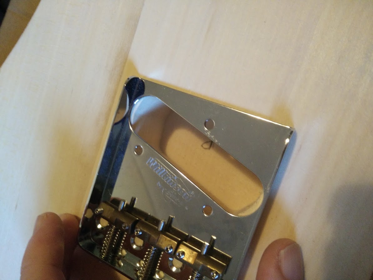

    Possible bridge pickup hole routing?
    Found a few moments to try a quick mock up, and found issue 1:
    My Wilkinson tele bridge pickup won't fit into the hole.
    Not much bigger than the hole, but enough that I can't force it. I also want a bit of wiggle room to be able to locate the bridge properly. So the hole needs to be bigger.
    I guess I can use the dremel or a chisel to do this - but would appreciate any advice before I start chipping away. Surely others have had this problem?
