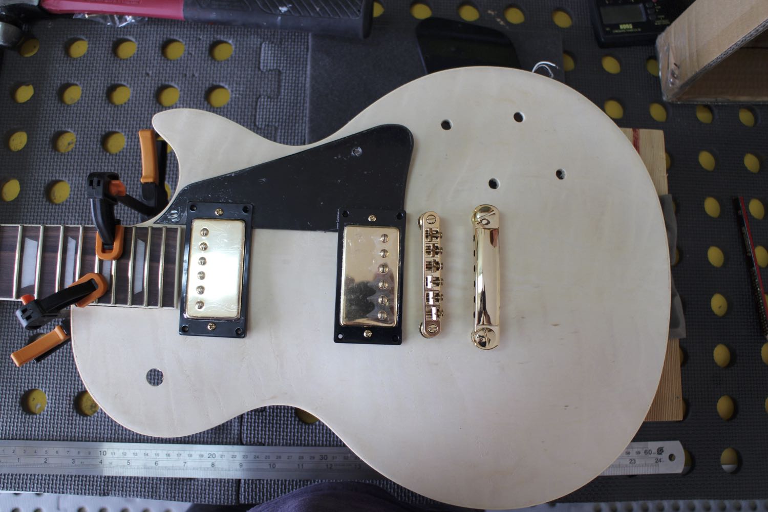

    Have done a quick mock build and like the action so will probably have to get some screws and a back plate as they are missing from the kit.....

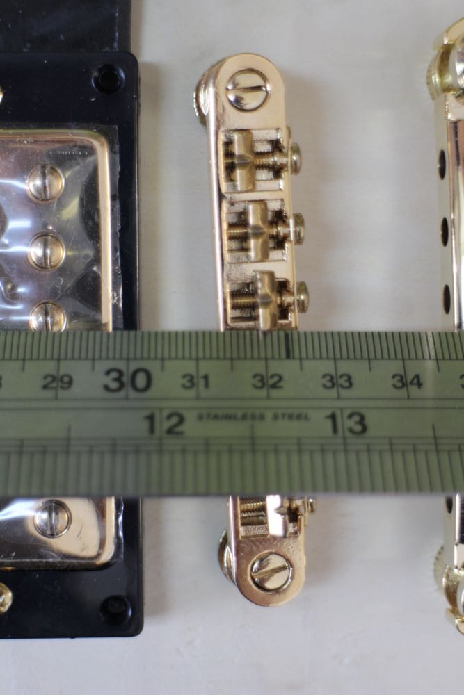

    1 question i have is the intonation.....i measured nut to 12th and got 313mm and yet 12th to bridge saddles was about 318 mm (See attached picture)...do you reckon i will be okay with this length given the string compensation required ????

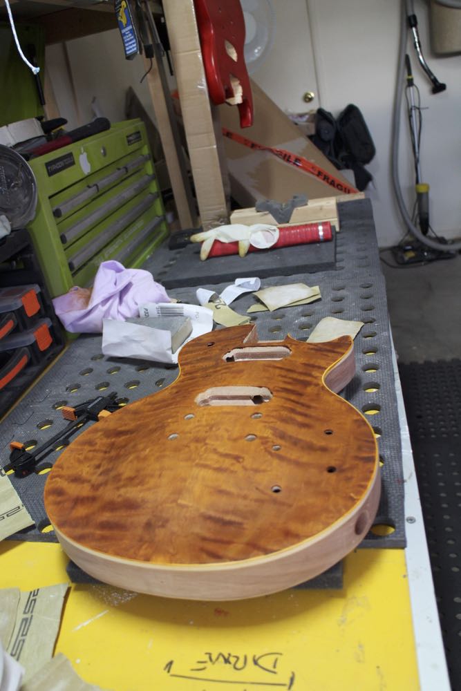

    So it turns out that i accidentally received a quilted maple LP not a flamed......Happy and thank you Adam for your help so far.....
    So got stuck into a little bit of light sanding and then thought....what the hell....time to try a nice golden teak stain with just a small drop of Jarrah thrown into the mix.....
    Pics to follow....
    Good stuff Bluesy, with your intonation the saddles have some forward movement so think you should be ok for intonation.

    Pics after following your advice WB.....fine sand with 320 grit....then 1 coat of F&W Golden Teak with a Splash of Jarrah for the top....and wow it sings to me.....Click image for larger version.

    That is unreal, an LP Tiger! Great work, absolutely love the way that top has come out, you've got to be chuffed with that.
    wow that looks unreal Bluesy, wait till you get some TO over that will pop like mad !
