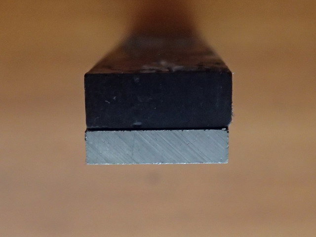

    OK heres what you need, i just started a rip down
    Some A5 L 2.444" x W 0.492" H 0.125"
    the A5 is thinner than the ceramic but will fit fine.
    Ceramic black Alnico Silver

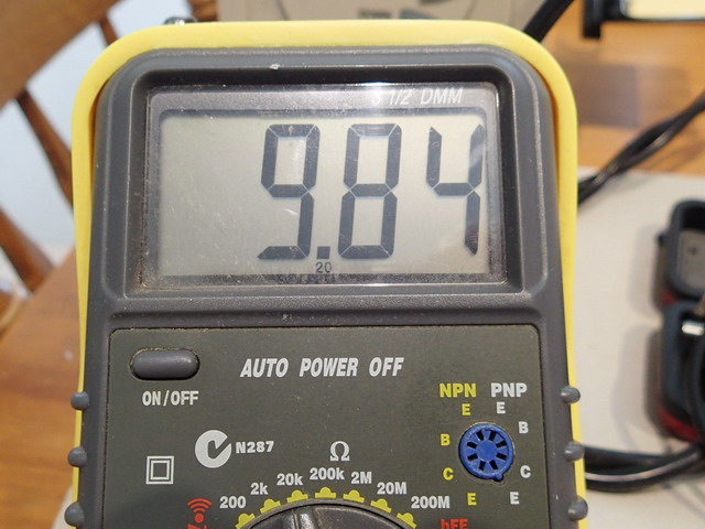

    Hi Andy i dont rewind them unless they are broken, although the inductance is 4.6H hich is pretty good, the resistance is is not bad around the 9.8K for a HB, these reading taken after i put the HB back together
    That H reading is far more important in determining a pickups tone, output than resistance
    Inductance
    Resistance

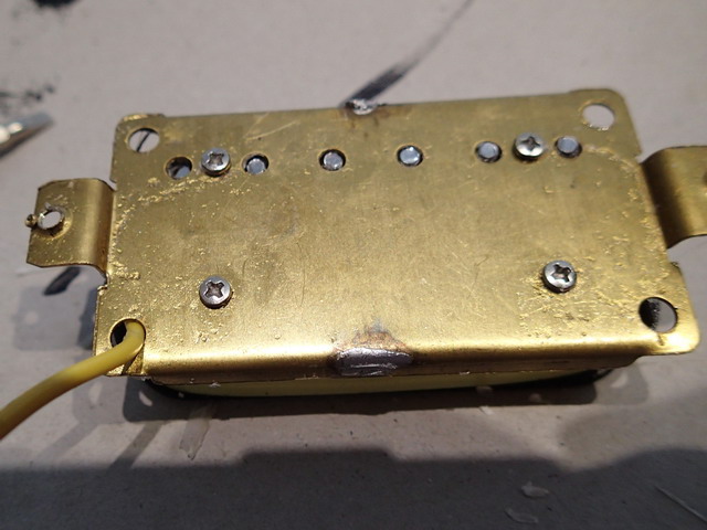

    Strip the surround of the HB then remove the solder i use my blade rocking back and forwards comes apart in seconds, just dont be too heavy handed
    Need to break the solder
    Into it with the blade
    Must have in the tool kit

    4 phillips screws need to be undone on the back of the base plate
    Out of the cover, theres some wax in there, they arnt potted, they just run some wax between the cover and the poles, and also underneath where the plate is
    Ceramic magnet is under the bobbins against the pole pieces, watch you dont stuff that wiring
    A view from the other end, this is the end i work from
