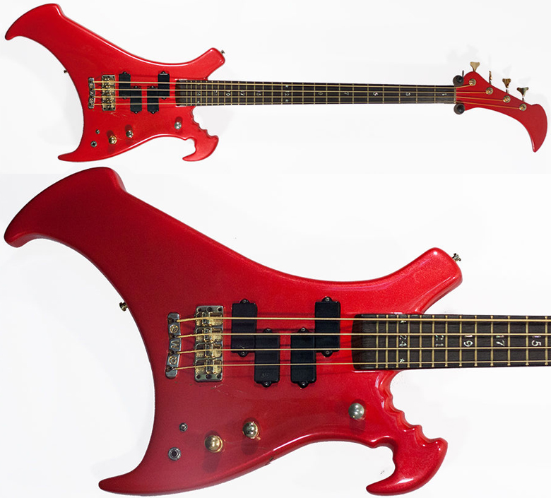

    I have a pair of P bass pickups lying about and was wanting to add them to my current PBass, any wiring diagrams / help? I have no clue. Sort of like this one here: Click image for larger version.

    On my Yammy fretless it had P Bass style in the middle and a Blade type at the bridge which sounded awesome. Not a huge fan of the split P's and see negligible benefit running a twin setup like that shown in the photos of your 1st post on this thread.

    I would also be inclined to reverse the Bridge pup configuration to the one in the pic, as the Bridge sound (Jaco sound ) needs to be quite close to the bridge to be effective, and it is most suited to the higher strings.
