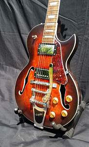

    I'm trying to get a similar colour to my Maton B1200
    I guess you'd call it a satin 'tobacco burst'?

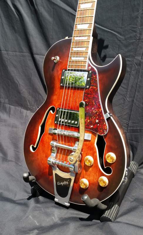

    Anyway, BuildYourOwnGuitar forum member 'neverwas' got really close with his ES-2V build
    But he used Wudtone, specifically 'Black Magic Woman' to get the deep rich black around the outside. (I would use B M W for the back, sides and neck too). Where he used 'Carmen Gypsy', I would substitute with Dark Amber.
    Do you have anything at Dingotone that is similar to Black Magic Woman?
