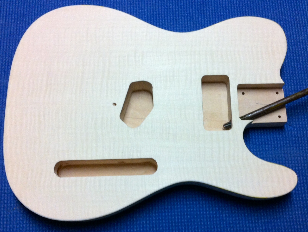

    With currently building 2 Explorers you would think I am mad to start another. The sad news about DIY closing down caused me to jump in a buy a couple more kits before I was ready and clearly I am now a GAS addict.
    Had a look of the body today looking for all the usual blemishes and surprised to find none at this stage.
    Maple cap is very thin and will be lucky to get a very light 320 grit dusting. Would love to grain fill or use a dark dye to pop the grain but too chicken to risk going through the cap so will play around with varying depths of colour on the top to create light and shade. For this one as it has white binding went with white pickguard and chrome hardware, Rosewood fret board. Thought long and hard about colours and as everyone has been doing blue lately will have a crack a doing Turquoise. Bought Epson 664 Ink Jet Refill Ink in Cyan (Blue) as it already starts out quite aqua blueish. Yet to do a few test runs on a bit of scrap timber to work out water to ink ratio to get desired colour. Here are some shots of the body.

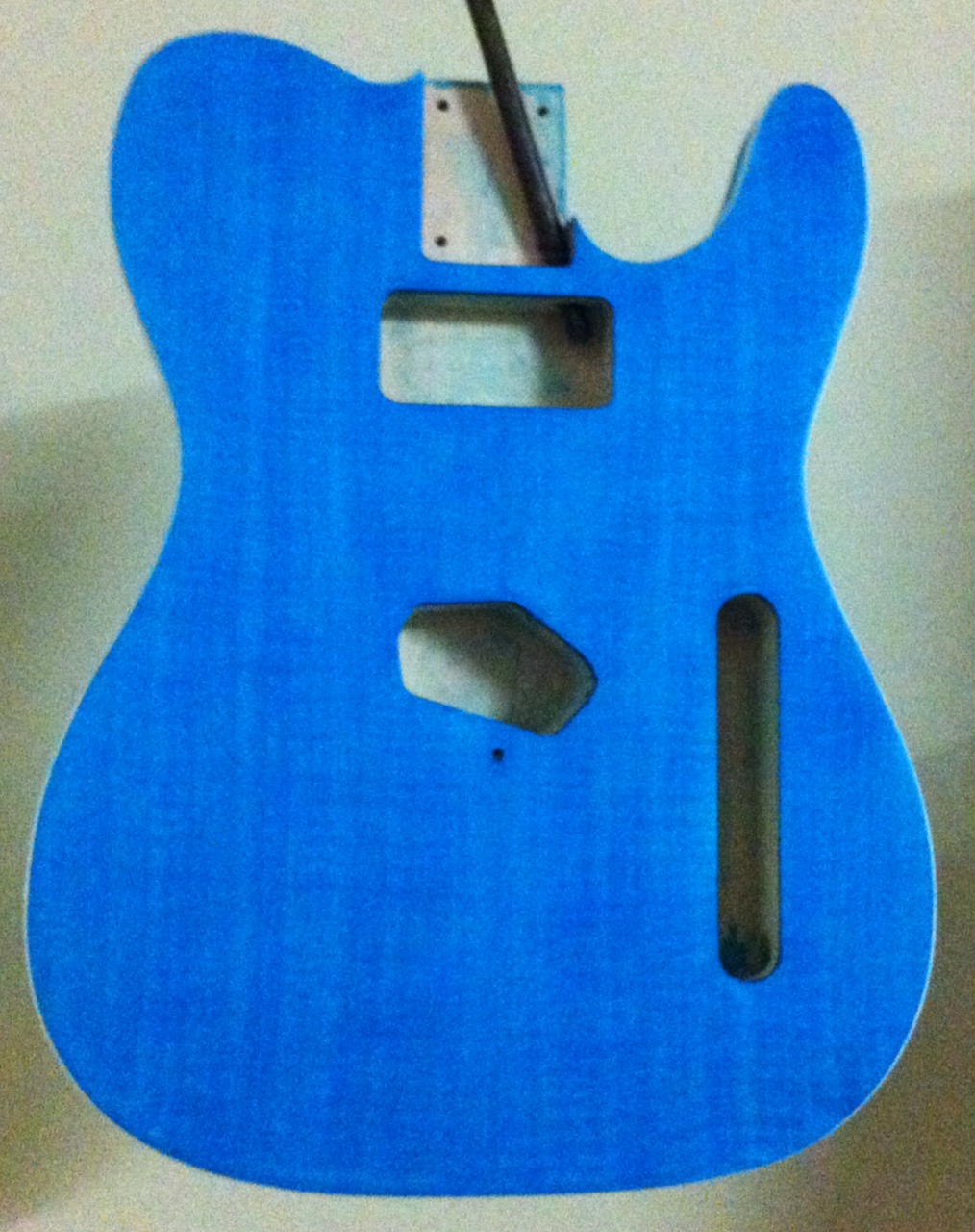

    Not much progress on any of my builds this week due to work and plenty of rain bringing with it high humidity which can wreak havoc with applying layers of finish.
    Been playing around mixing colours instead on a scrap bit of pine ply as per following shots. Leaning towards 1:4 ratio of ink to water as any higher strength on the top may suffocate the flame maple. Reading other threads makes me nervous with too much water content as don't want to affect the thin cap. Back and sides might end up darker due to nature of basswood and also as a contrast too.
Name:	photo 3 - TO over blues.JPG
ID:	8163Click image for larger version.
Name:	photo 4 - TO over blues.JPG
ID:	8164Click image for larger version.
Name:	photo 5 - TO over blues.JPG
    Next shot is both blue ink & red food colouring added to Tru Oil to see how that worked (Red is for the J Bass yet to be started).
Name:	photo 2 - Red & Blue in TO.JPG

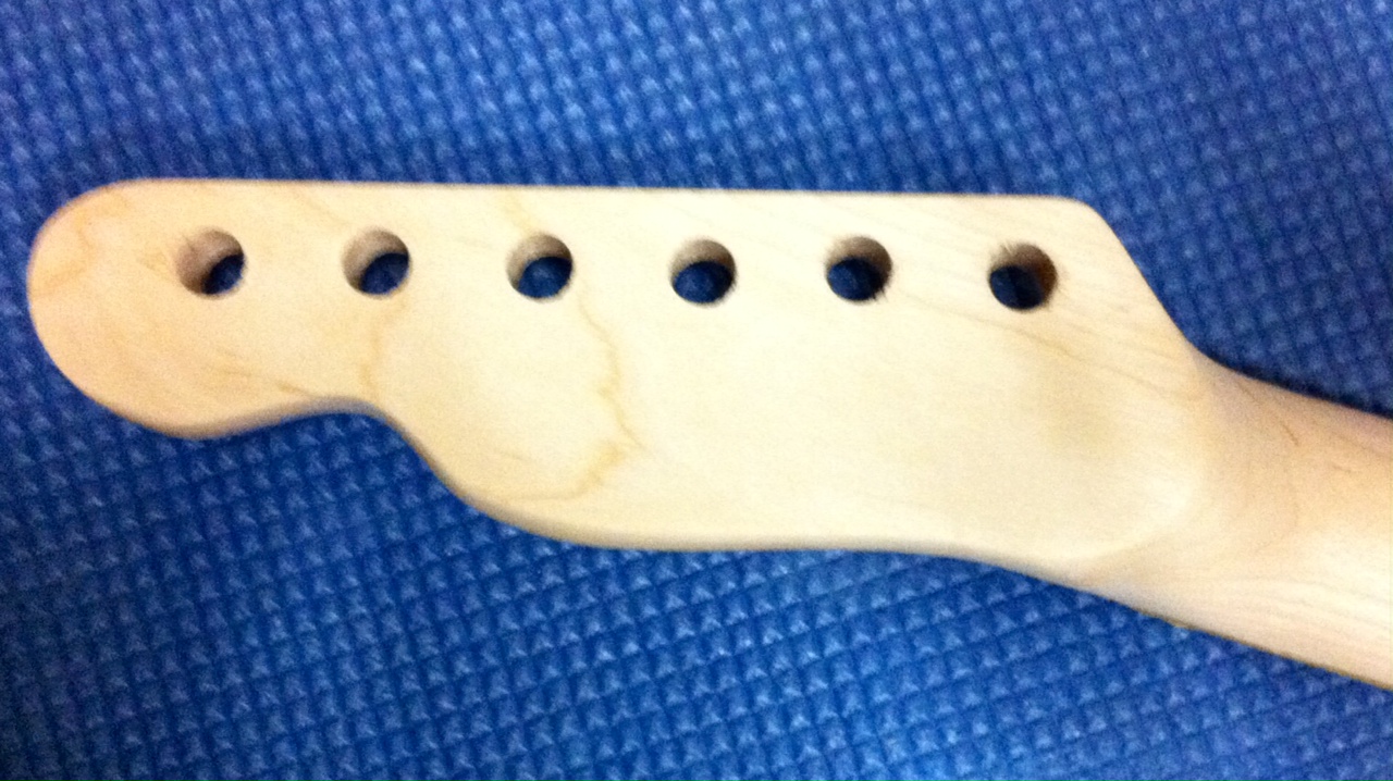

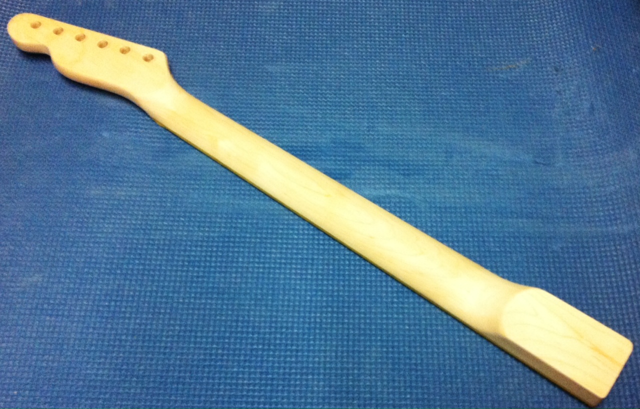

    Decided to make a move on both of my DIY non-pitbull F style guitars last weekend and here are shots of the progress over the past week.
Name:	photo 5 front of body.JPG
ID:	9749Click image for larger version.
Name:	photo 1 Shaped front of headstock.JPG
ID:	9751Click image for larger version.
Name:	photo 3 back of headstock after shaping.JPG
ID:	9752Click image for larger version.
Name:	photo 2 back of neck after shaping.JPG
    Put on first coat of stain only to find more glue spots. Had used plenty of Goof Off but sadly not enough and even had to use a small wire brush to encourage the crap to leave this planet. Below shot was late at night so lighting was not so good in the garage. Put a coat of TO on it earlier today and will post some shots once dry as the flame and colour has really come up strong. Also stained the back of neck and both sides of the headstock and amazed at how much the Bass Wood has thrown a slight green tinge. Looks cool and you will just have to wait a little bit longer for those shots too.
