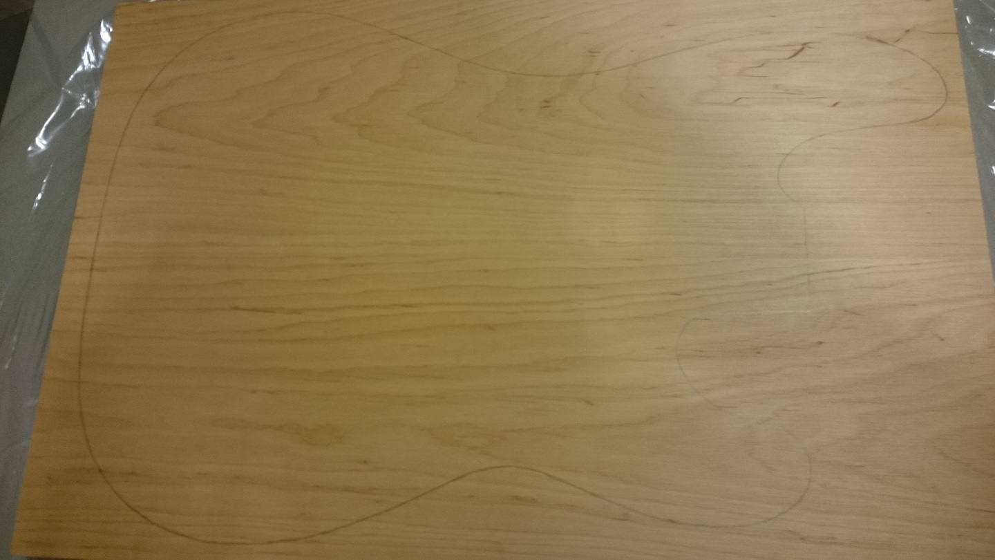

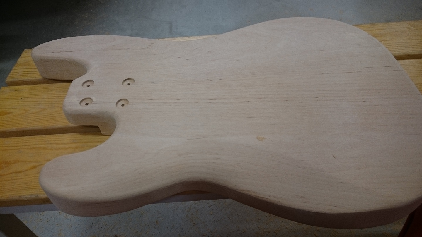

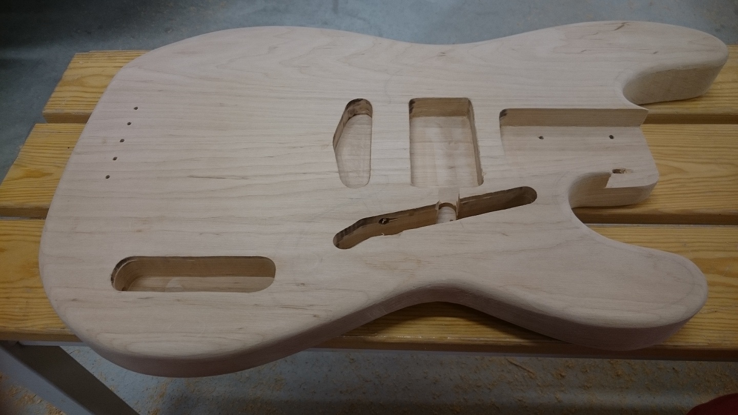

    I ordered a body blank made of alder from a Finnish luthier shop in Oulu. Received this one planed and sanded to 43mm. I have never tried a blank before so here goes...

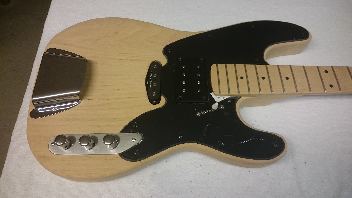

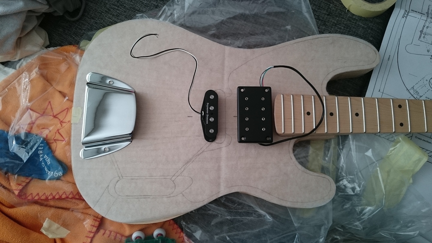

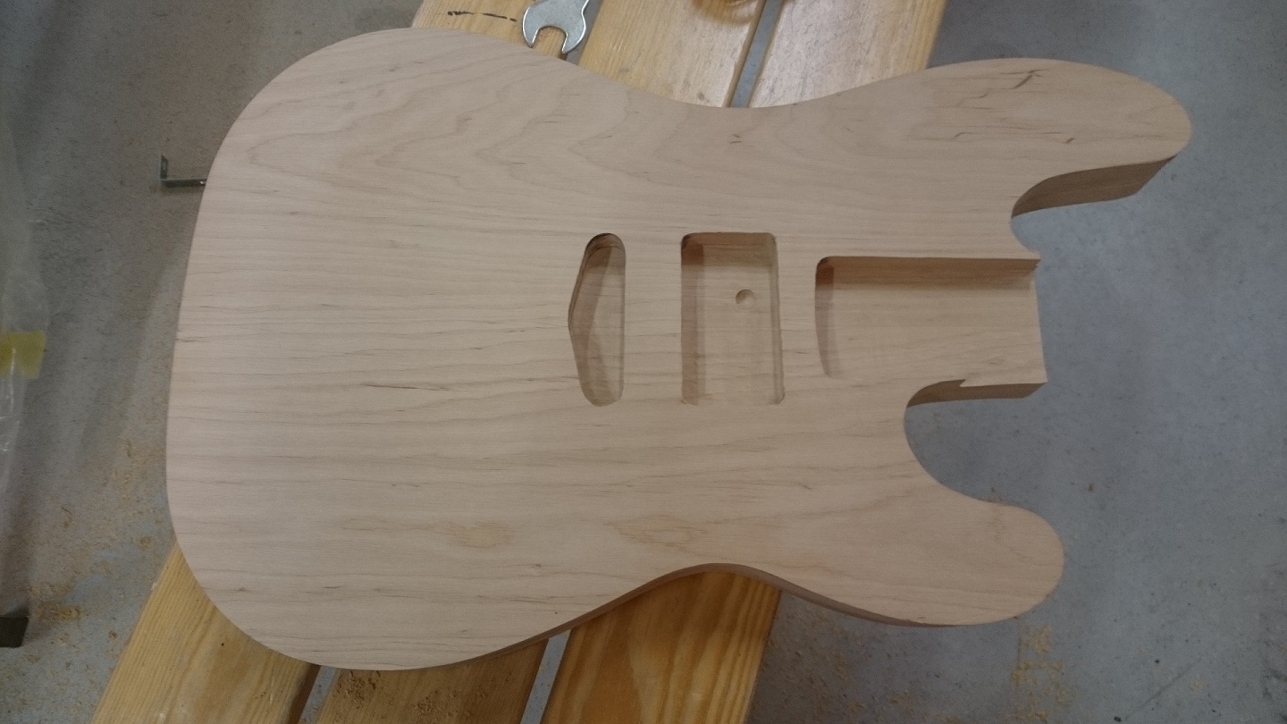

    I then ordered 1:1 scale blueprints of p51 bass to work with. Then one by one scouted the parts I wanted for the build. Got a Dimarzio DP120 or "Model One" and a Seymour Duncan SCPB Quarter Pounder. I have no idea how these will interact but I figured they both are close to same output 12-13 kOhms and that way would propably not "drown" one another too easily. Got some p51 ashtray, Wilkinson bridge and tuners etc. Decided to combine these with a 4-way Grigsby suggested by Weirdbits so that I could get these to work by themselves and in series/parallel. Went with one tone and two volume switches. Here is some planning with parts and a copy of the blueprint.

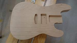

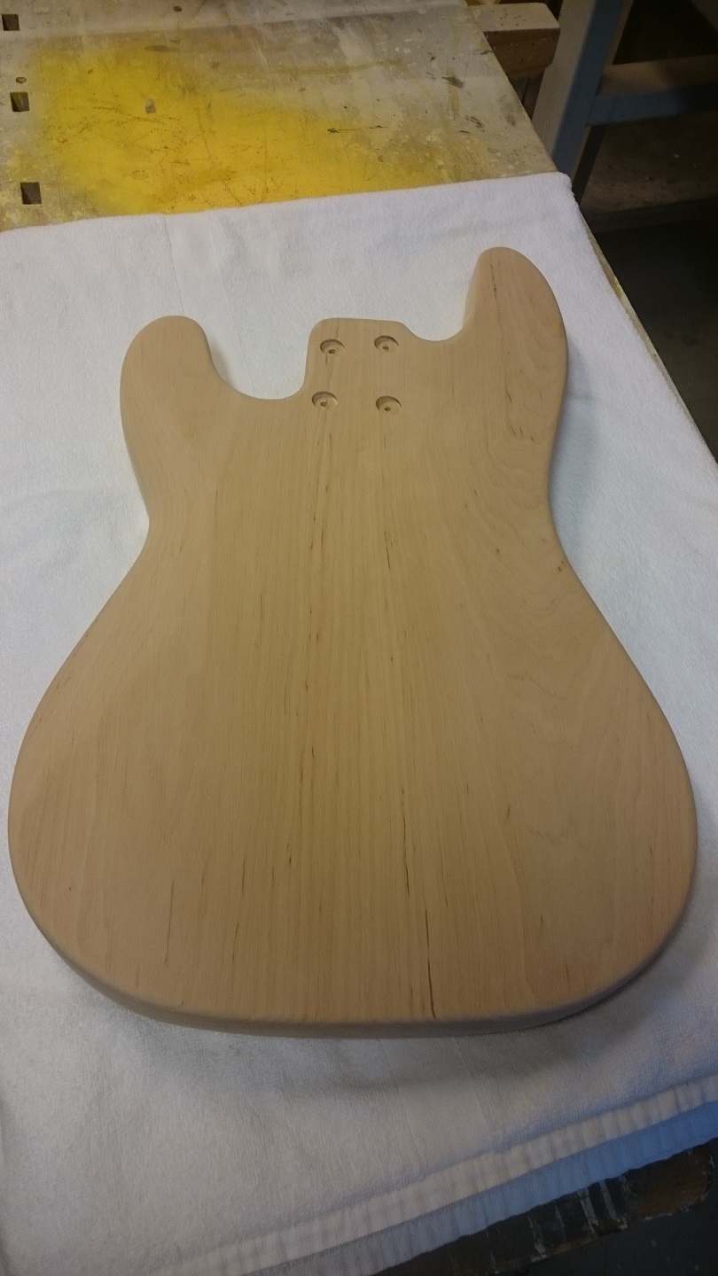

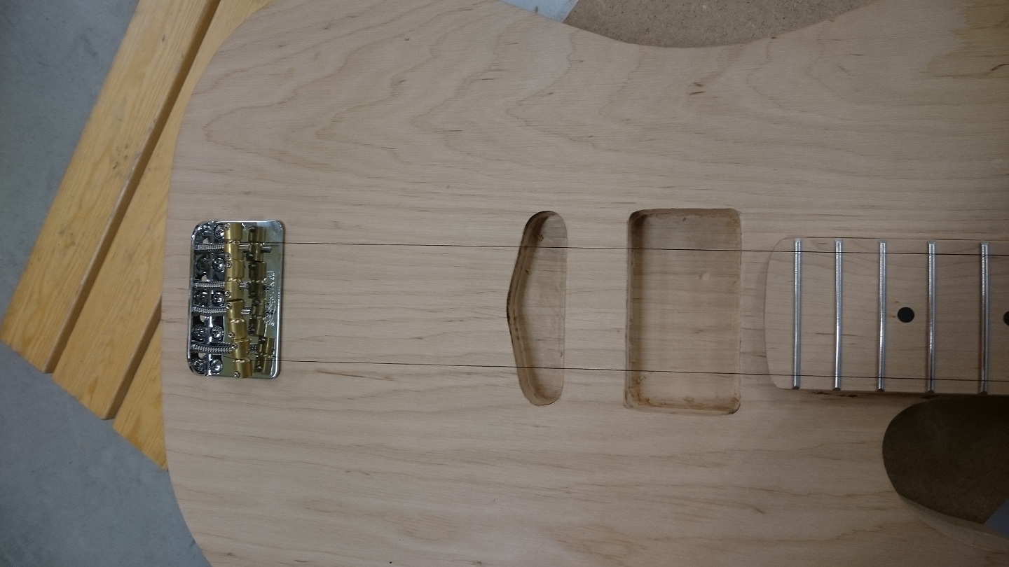

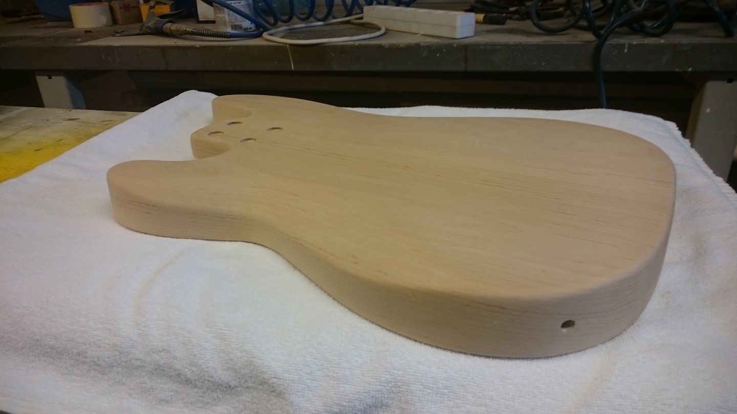

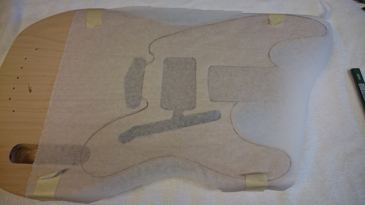

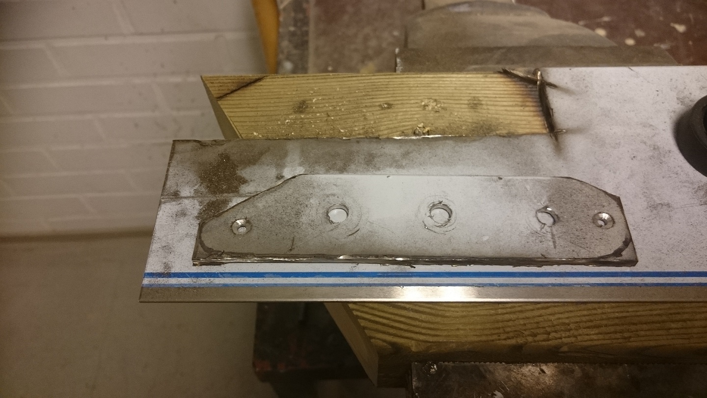

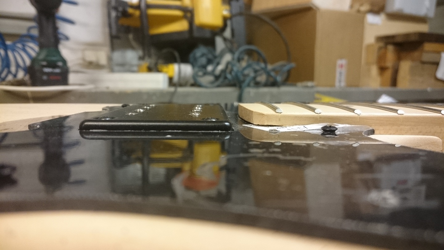

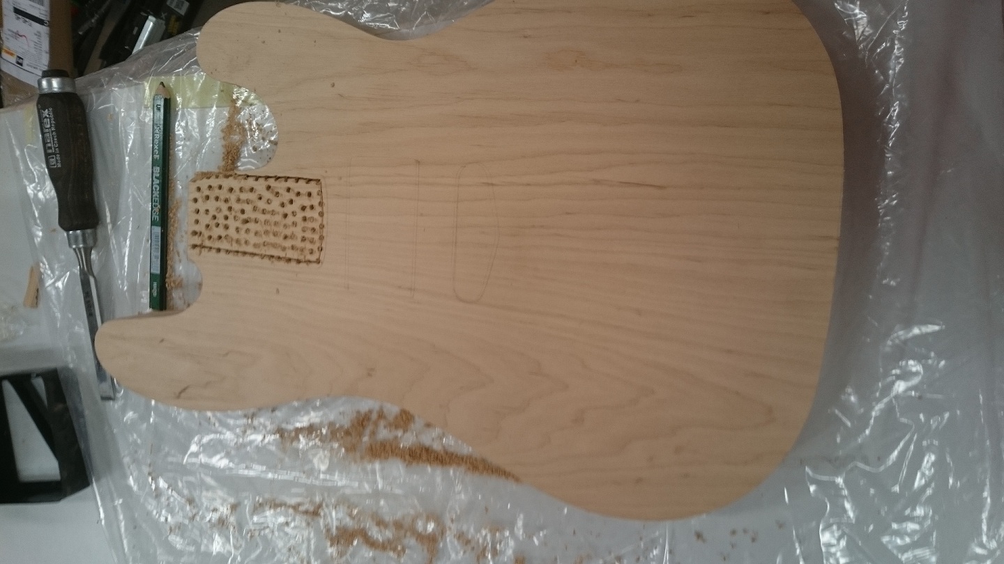

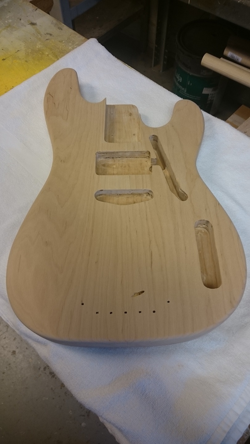

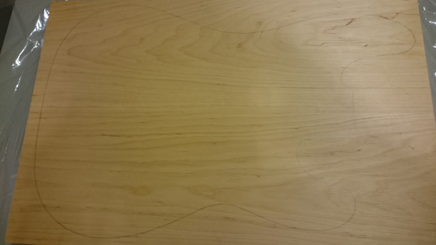

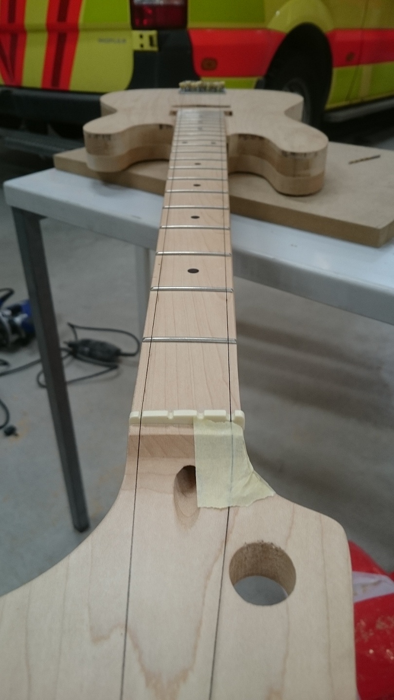

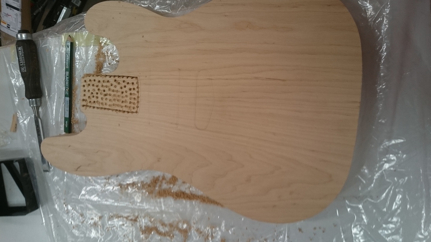

    First time I had a space where I could route and sand I went for it after I had drawn the template with a pencil... YES! I measured the placements and did not have a template for routing. I did however buy a router and some flush trim bits with ball bearings.... decided to rely on my trusted Dremel for the finishing of the edges.

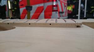

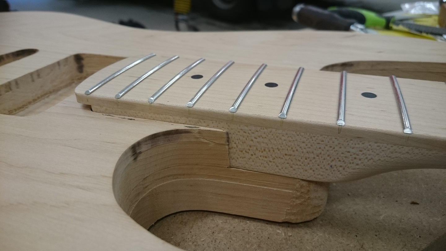

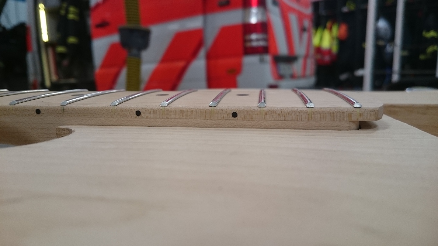

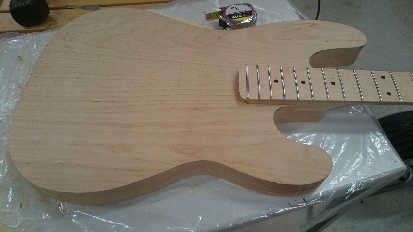

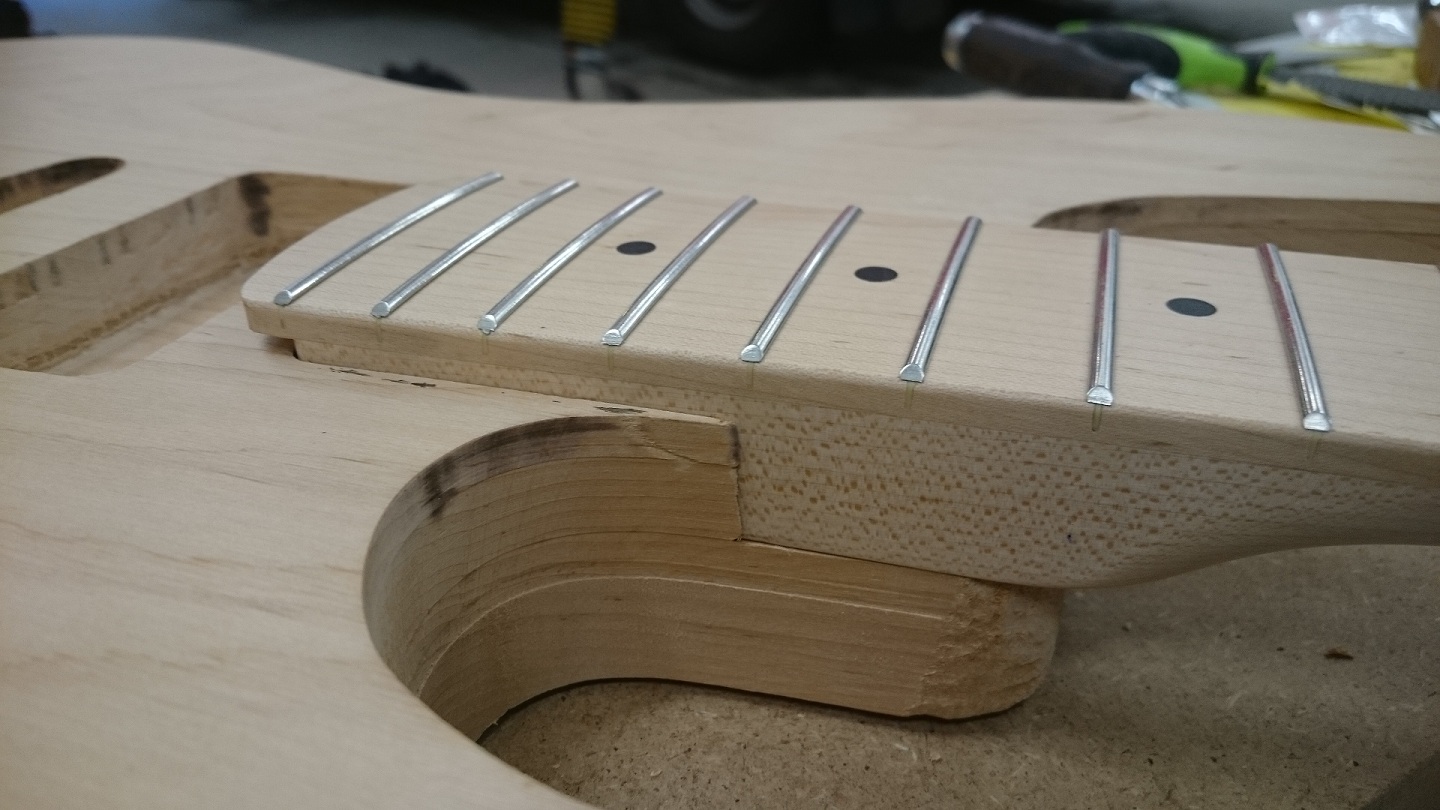

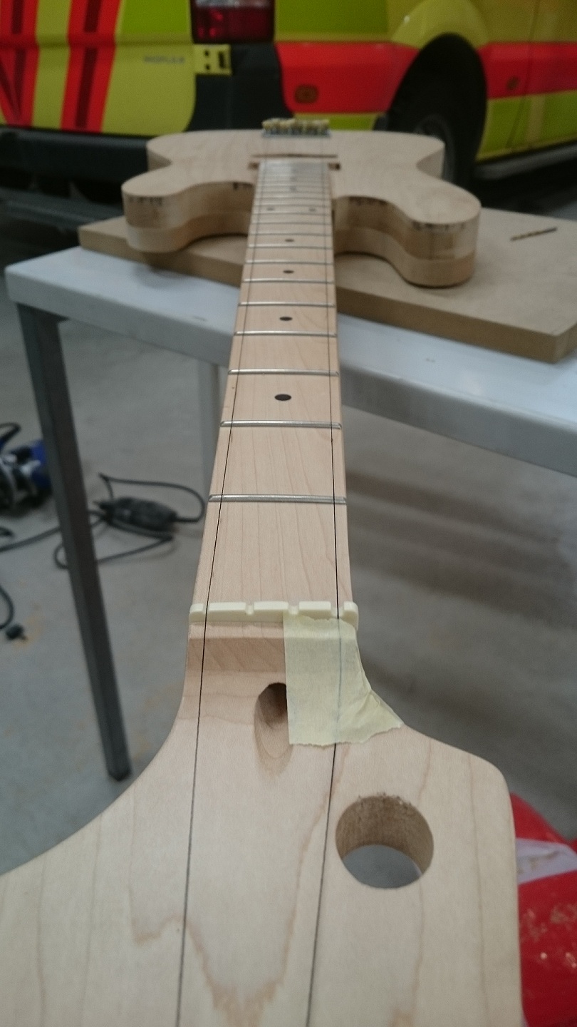

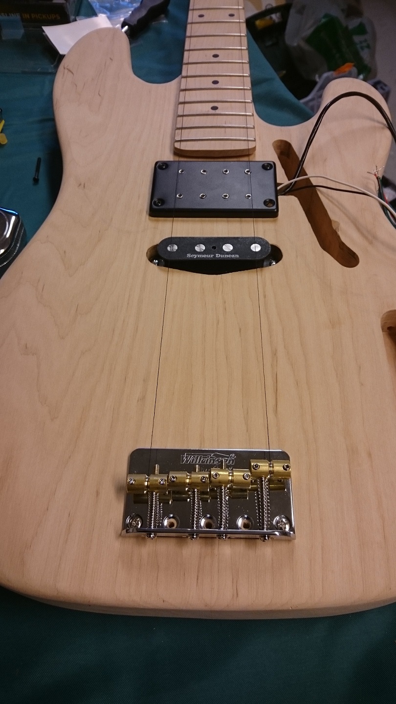

    The second day I had to make the neck pocket and neck pup cavity deeper and routing I did...
    I also attached the neck with flush ferrules for a change, then placed the bridge.

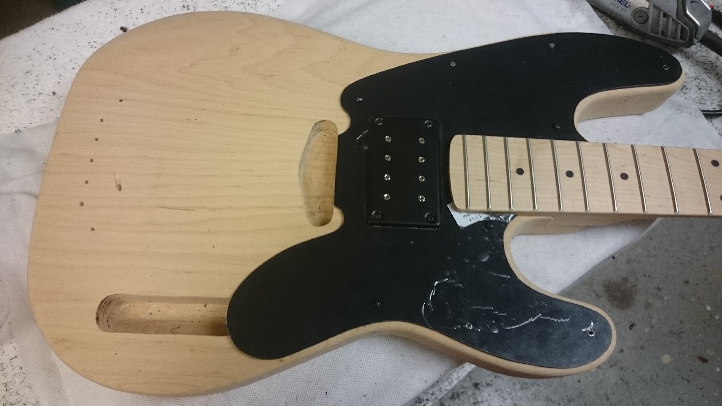

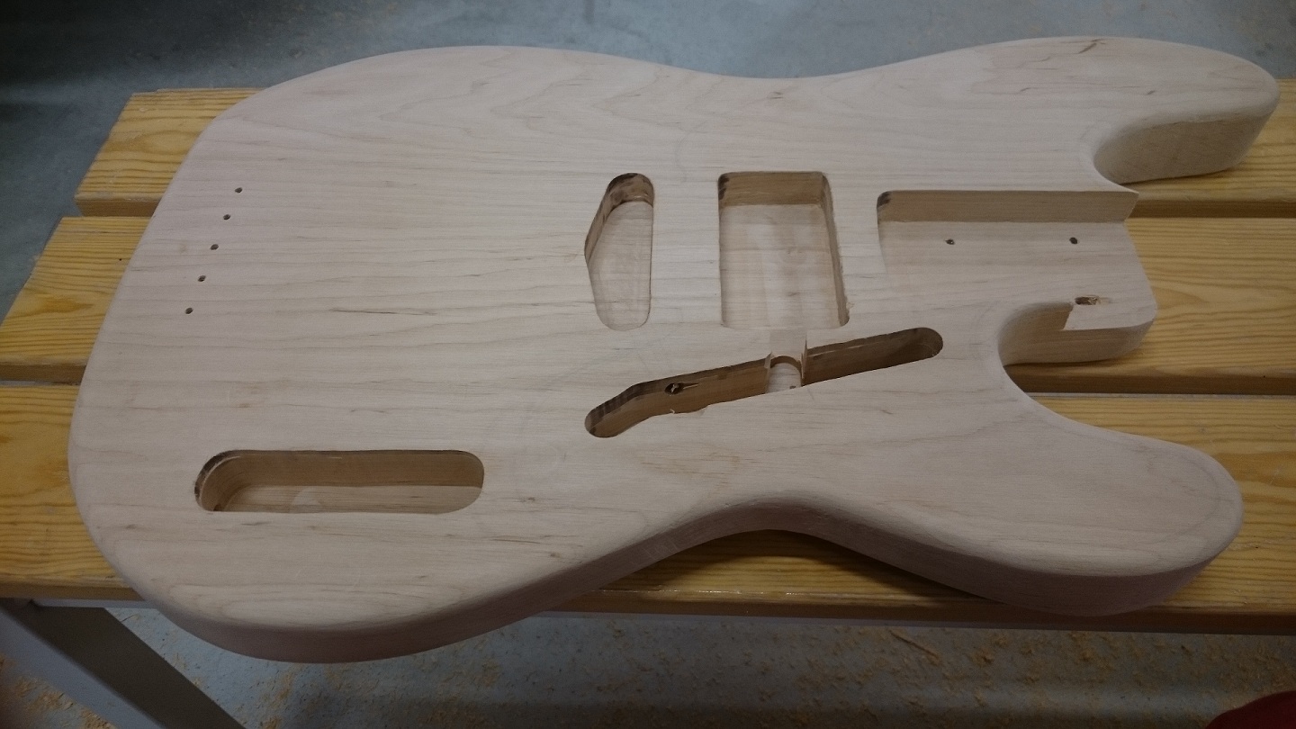

    After this I went on to making the comfortings with a rasp and I think I did ok for a first timer. As you can see from my previous pics - I have to shape the heel of the neck because I had the router slip on me on the neck pocket... This is one reason I went with attaching the neck with ferrules. Shitty way to change plans on the way...
    Anyway - Routed the cavities for the electronics also and drilled holes for the wires. Next it's sanding and more sanding until the body is ready for the color.
