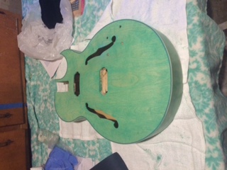

    Just applied the first coat of Wudtone in Surfer Girl. So far, I love the guitar!
    -Mads

    Nice! That surfer girl really is an awesome colour. Looking great.
    That looks like one of the most even finishes I've seen with Surfer Girl, especially after only one coat.
