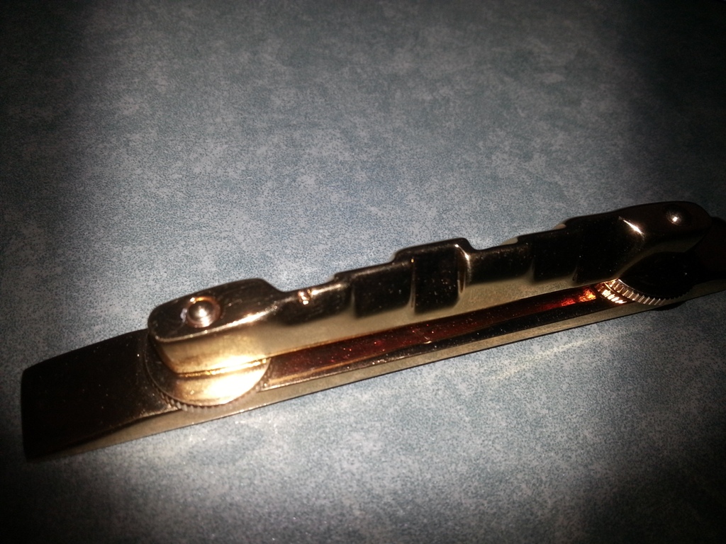

    PFFFTTTT. can't win a trick with this thing. bought a gold bigsby bridge, a little higher than the Sorkin Bow tie, but at least it's the right colour. Their is a pock mark in one of the bridge slots.
    See pick below. looking for ideas on how to manage this.
    Cheers PK

    Hi PK, I know it's a pain and will delay the build but I'd ask for a replacement from the bridge supplier. Send them a photo and they may let you keep the damaged one you have !
