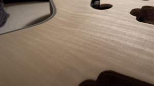

    HI Gavin,
    Thanks for the reply. Pic attached, probably doesn't show it very well, actually it makes it look slightly worse than it is.
    I spent maybe a 2-3 minutes sanding with each grit? I'm new to this whole sanding lark.
    As i mentioned, the surface is very smooth, so maybe once I apply the stain etc. it won't be as noticeable?
    Thanks again
    John

    Moderator dingobass's Avatar
    4,491
    Hey John,
    Noice kit
    With the veneers, you can always expect some pits.. Best not to over sand it as Gav pointed out.
    Sand it to 400 and go mental with the stain
    Most of the pits will be filled by the Intensifying and top coats. As each layer cures, you can gently scuff sand with the 400 grit... Just don't get too carried away
    By the end of the finishing process most if not all will be filled.
    If you have any dramas, just yell out!

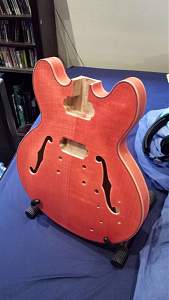

    So heres the body after 4 coats of Karijini (front and back).
    I'm after a deeper red but wood colour is showing through giving it a salmon-ish hue.
    So getting a second bottle of stain delivered so i can apply maybe 2-3 more coats.
