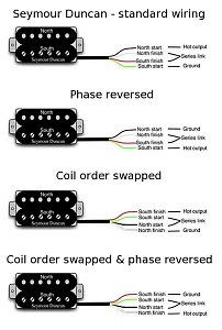

    First, a note. Mixing pickups types, particularly from different guitars and/or manufacturers etc, can require a bit of extra work. When combining the pickups you may have issues of phase and, if you're linking a single coil to a split humbucker, potentially hum-cancelling problems - or lack thereof. Essentially, you need to work out if the two pickups are in phase and, when split, which coil will give you a hum-cancelling pair. If you're lucky, you can just look up your pickups and see how they need to be wired. Alternatively, you can use a multimeter to test the pickups (this video may help), but connecting the pickups/coils with clip leads in various combos and into a headphone amp will soon tell you if you're humming under fluoro lights.
    For consistency, I've use Seymour Duncan colours for the humbucker wiring in the following wiring diagrams. This means that the coil pairs are black & white and red & green. Depending on how you wire your coil splits, one coil or the other will be active when split. If the active coil is the one you need for hum-cancelling, great. If it's not then you either have to change your split wiring, or change your coil ordering so you get the coil you want. Same goes for phase issues.
    So, if you need the red & green coil for hum-cancelling but the split wiring gives you black & white, then you need to swap the coil order as above. Note that reversing the phase automatically changes your coil order, so if your have the correct coil but it's out of phase then you'll need to reverse the phase and swap the coil order. If you check the diagram above, the first and last example have the same coil order but with the phase reversed. I'll make a note with each of my diagrams which coil is active for any splits. The key is to work out the colour pairs for your pickups and then translate them to the colours I've used.

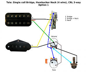

    3-way Lever switch diagrams
    Standard Tele layout, no splits:

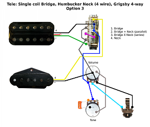

    Standard Tele 4-way layout with parallel and series combinations, no splits:

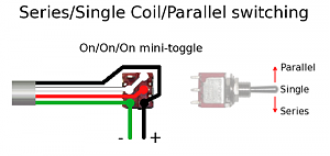

    While it's possible to do a lot of switching and splitting options just using 3, 4 and 5 way lever switches, I think the most flexible and usable layout is the above standard Tele 4-way layout in combination with an On/On/On mini-toggle. The 4-way lever switch allows you to combine the pickups in either parallel or series, and a mini-toggle will allow you to set the neck humbucker as either series, single coil, or parallel. For maximum flexibility with the easiest wiring, you just wire the toggle switch like below and then connect the + and - to the 4-way as shown in the diagram above.

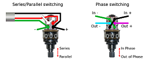

    Adding a mini-toggle to the standard 3-way wiring has the same effect, albeit without the series between pickups option.
    Push/Pulls can also be used for series/parallel switching instead of a toggle switch, or even for phase switching if you want a scooped nasally sound when your pickups are combined. A push/pull is also an easy way to add coil splitting, as you can directly control which coil is active (let me know if you need a diagram for that).

    Hi Scott. I am modifying a Tele with a Lollar Tele Special Bridge PU and Imperial neck HB using the 4 way lever switch and 3 way mini switch as as described in your post. The Loller HB has 4 conductor wires + a braided outer wire. I have been assuming that the Lollar HB has the same wiring colors as the SD in your post, but this could be incorrect. I was also unaware of that there were two types of the 3 way mini switch. When I finished putting the guitar together The 4 way worked as expected but the neck PU produced no output in the middle (split) position and there doesn’t seem to be any discernible difference between the up and down positions. Any insights would be greatly appreciated.
    Thanks

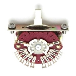

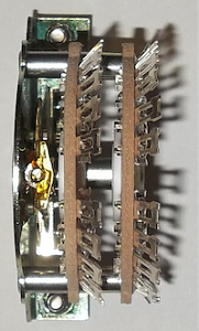

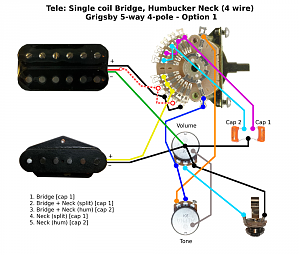

    The 5-way 4-pole is a much larger switch with the addition of a second wafer. It will squeeze into the opening of a PBG TL cavity, but the cavity will need to be deepened and, in my experience, a bit taken out of the side wall (like an undercut) to ensure clearance when the switch is in position.
    With so many lugs it's difficult to show how to wire the switch with an actual image, you can't see all the lugs from any one angle. So, I've modified a side view with the inner wafer sticking out so that all the lugs are visible and you can see, mostly, where the connections need to go.

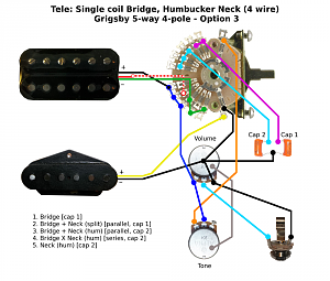

    The extra poles on the switch means that you can also do things like having different tone capacitors for different postions/pickups. So, in all of the following examples, one of the switch's poles is used to select between two different capacitors, cap 1 for single coils/split, cap 2 for humbucker combo's.
    Bridge with split neck in position 2, and split neck in position 4 (red & green coil active when split):

    Bridge parallel with split neck in position 2 (black & white coil active when split):

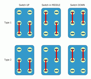

    Hi Scott @WeirdBits
    I am assembling a Telecaster with Humbucker at the neck and single coil at the bridge and this type of solution is interesting.
    But if you can I need some clarification:
    - there are two types of mini toggle switch on / on / on for the central position
    for which type is the connection right and how would it possibly be for the other?
