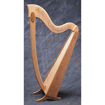

    As a luthier we are into things with wood and strings, so since my other half is wanting a harp, I figured I'd rather build her one than buy one. The satisfaction will be immense! Plus - can you imagine the points I'm going to score...!!
    So after doing some research on Youtube and google I came across MusicMakers and a Studio Harp they offer plans and some parts for.
    They do not ship any wood which keeps the price down, but the plans and the smaller parts are all shipped out.
    This is what I am hoping for at the end of the project. Apparently can be assembled in a day!
    I have the option of the low feet or tall feet as in the two pics below. Pic on the right is on the front cover of the instructions sent by Musicmakers.
