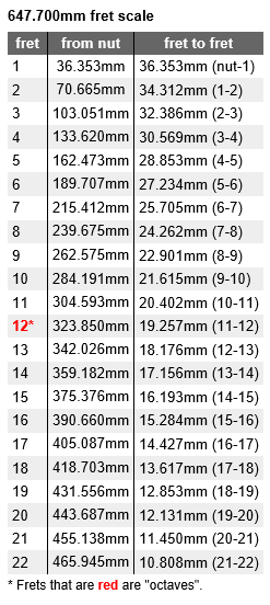

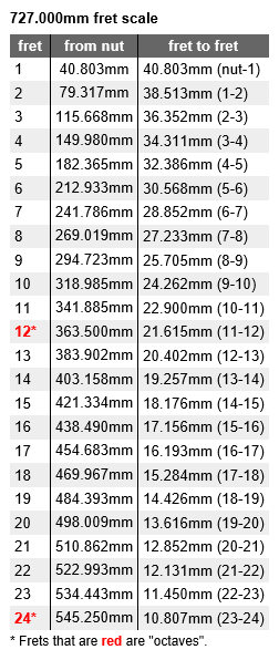

    Here are the scale lengths for the two guitars Warmouth mention.
ID:	4678   Click image for larger version.
