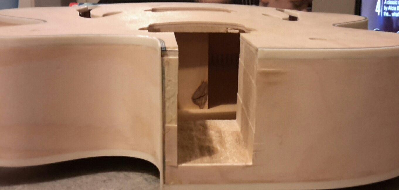

    Hi, Thanks everyone. Whelp, the GR arrived today.Beeeutiful. Has some laminate missing/lifting fromthe neck pocket but other than that awesome. Will try and upload pics in a bit. Thinking it's ok.
    Canberra
    42
    What do y'all think, fixable?
    Quote Originally Posted by Danglez View Post
    definitely
    get some glue in behind the lifted laminate and put a clamp with one end on the fix and the other in the pup route area to put direct pressure on it.
    Alternatively to a clamp, wrap tape around from the top bout , over the repair and into the neck pocket.
    Just find a way to put decent, even pressure over the area until the glue dries (titebond is perfect).
    You may need to sand any over spill from the repair if it gets onto the top surface - if you do, go easy the timber can be thin
