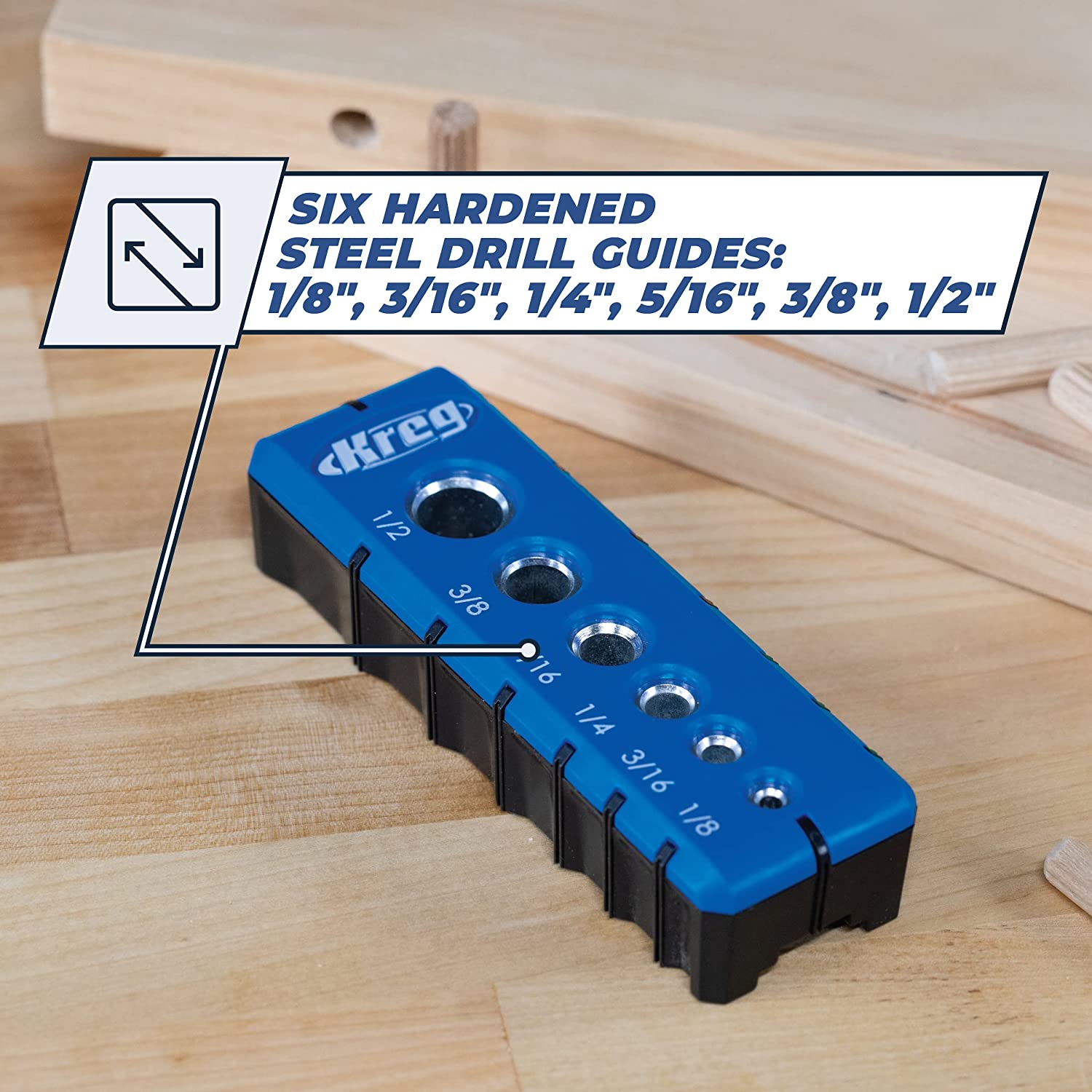

    I did have a drill stand for many years, actually it use to belong to my father, skill shear brand, wasn't too bad either did the job but only fitted the skill shear electric drill, until I bought a drill press, now that's gone. I will have look at Bunnings see what they have, maybe an Ozito drill press, or buy swap and sell local market, tight dollars. I would have to set up table and a jig for resting the neck on so to keep it 90degrees to the drill bit. Making a template from the neck plate wont be an issue, easy done. I knew it wouldn't be perfect but didnt expect that.

    Maybe something like this will help? Click image for larger version.

    Cheaper than a drill press or even a drill stand. I built something like what I think Simon was suggesting, and can post a pic if you like, but it may be overkill for drilling on a body with a flat top and back.
    Thanks Fender 3X I did just that, made up a 90degree jig worked just fine. Cheers.
