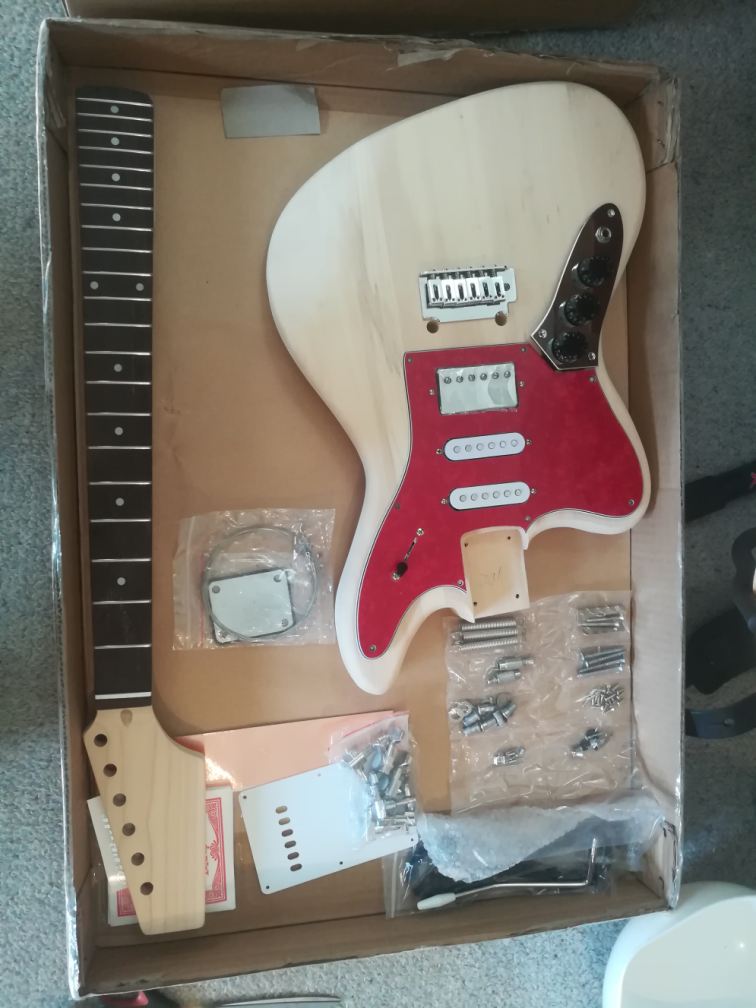

    Just got a JM-1L kit delivered today. It looks quite good, the wood is pretty nice. I'm thinking either a nice light stain or just satin poly to seal it would look great. The frets are pretty good but still need to be levelled and smoothed. The wood is smooth already and won't need much work.
    Two questions:

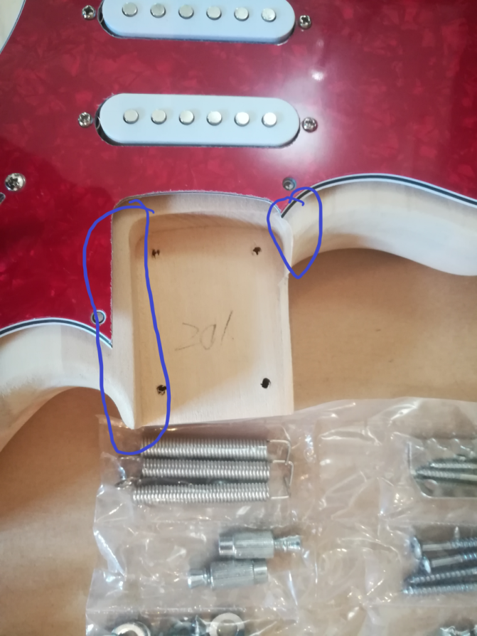

    1. The neck fit is a bit too tight. Do I only sand on the sides that I have circled in the picture?
    2. The bridge is weird, it is not mentioned in the instruction pdf. It is kind of like a strat but doesn't have mounting screws. Does it basically just get wedged under the two posts? Also one of the posts is not a super tight fit, I'd be kind of worried about it falling out, is there anything I should do there or is it all good once everything is wedged in?

    I should have clarified, by a bit too tight I mean that it doesn't quite go all the way in, there is about 2-3mm of gap. Although when I measure the scale length with where the bridge will sit it actually looks right. So is it supposed to go all the way in, or does leaving it where it is as long as everything is straight work just fine?
    As the neck widens as it goes along, the neck drops in from the top, you can't slide it in.
    If the holes in the neck for the screws have been pre-drilled, and with the screws in position the neck has that gap, then that's wrong. If it's something else, then a photo would be helpful. Unfortunately the way the necks on the kits fit into the neck pockets often leave a bit to be desired in the way they mate up. Sometimes you can sand the end of the neck for a better fit, but if the scratchplate hides any gap, then I wouldn't worry too much about it.
    Those two-point trems are always a balancing act and the trem will fall out if you let it. But it's the the same on any 2-point trem, be it Fender or Floyd Rose or an Ibanez one etc.
    Don't bother fitting it in place until you are ready to string up. You need the trem claw installed (not forgetting its ground wire). It's best to wedge the trem block in place once you've fitted it so that it can't move backwards and forwards. If you can make a wooden wedge for each side, or glue bits of card together. I also use masking tape along the main axis of the guitar to hold the bridge in place against the posts, leaving the two E saddles clear so you can run strings from them to the tuners so the string tension then holds the saddle in place. You can then remove the tape and fit the other strings. At some point you can fit two or three of the trem springs. I'd fit two to start with so you can keep the wedges holding the block central with the springs to either side.
    The trem base plate should be sitting about 1/8" / 3mm from the body and parallel to it. You want it flat, and not angled backwards or forwards for best trem performance, so adjust the post heights and any wedges. If you only want down bends, not up and down, then you can set the bridge plate a bit lower, but you still want it at least 1mm above the body and parallel to it.
    Use the kit strings in the clear plastic wallet for initial set up, then use the Ernie Balls once you are happy (the kit strings are really bad, have uneven string to string response and sound dull, but if you need to take the strings on and off at all during setup, better to do it with the bad set).
    With the wedges in place and the strings fitted, you can then set up the bridge saddles for correct string height. If the saddles are as low and they can go and the action is too high (having first set up the truss rod for very slight concave neck relief), then it's best to fit a small shim in the neck pocket to increase the neck angle so the saddles can be adjusted to suit you. The shim won't need to be thick. A piece of veneer or a bit of old credit card should do. Just use something fairly hard, not too soft like card or paper.
    Once the action is set up, you can then remove the wedges and adjust the trem claw screws to bring the trem plate back to parallel again. You'll probably need to adjust the claw spring and string tuning a few times before it all settles down. However this is no different to a 6-screw trem. The only difference is that a 2-post trem will fall out when not held in by string and spring tension.
    I'd then swap to the good strings, changing them one at a time. Always best to change the strings one at a time on this type of trem to keep it in place, unless you need all the strings off to oil the fretboard or polish the frets.
    The trem posts and the post inserts should be the same size. Have you measured and checked? You normally wouldn't want to try fitting the post inserts into the body until you've applied the finish. You can do, but you'd probably then want to fit some suitable bolts (probably M6 for those posts) into the holes to stop the threads getting filed with finish.
    The holes in the body for the posts should be roughly the same diameter as the post inserts less the depth of the splines. They certainly shouldn't just drop in and pull out, you'll definitely need to tap them in quite hard with a hammer. So if you can drop them in, that's very wrong and they may have used the wrong drill bit. Those 2-post inserts are smaller than most of the post inserts used on other kits. If the holes are too big, I'd send the kit back. If you were more confident, you could fill the holes then re-drill, but you really need a drill press to do it and it's easy to mess things up. Plus if you are staining rather than painting a solid colour, you'll see the edges of the plugs.
    If in doubt, take and post pictures. And measure and check as much as possible. I find a set of cheap digital callipers are invaluable when working on guitars for checking all sorts of things.

    If I put the neck in as snug as I can get it, there is a tiny bit of space at the end:
    Although it seems to have less space on the other side:
    With the pick guard on it fits flush and you can't even tell that there is a gap:
    For the bridge posts, they are snug, but I can get them in and out with my fingers. I don't have calipers to measure. I could probably just work around this by stuffing a couple of toothpicks or something in there and make it tighter.
    Whilst you can finesse the end of the neck to fit the pocket, if you can't see it, then it doesn't really matter as it will touch the end of the pocket at one point and that's all you really need.
    But if those post inserts are just finger tight, that is definitely wrong. Whilst I'd happily fix scratchplate screw holes with cocktail sticks, the trem posts exert a lot of force on the wood and you need a solid foundation round them. Now it may be that the holes were drilled for a different bridge that has slightly wider posts (I'd expect the Chinese kits all to use metric sized posts but some other trems have imperial sized posts), or it may just be that they used the wrong sized bit. But it's not right and I'd notify Pit Bull and get it replaced. The neck gap is minor, but over-large post-holes are major items.
