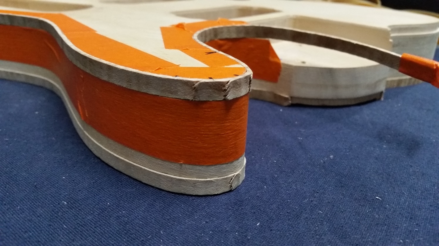

    Next challenge is to shape (well pre-shape) the curly maple binding. After too many YT vids, kind of mashed up most of that into something that sort of worked. Soaked the binding in ammonia, wrapped it in foil and used a hair curler as a bending iron.
    First piece on the body with excessive use of tape, you can see the foil around the binding by the neck pocket

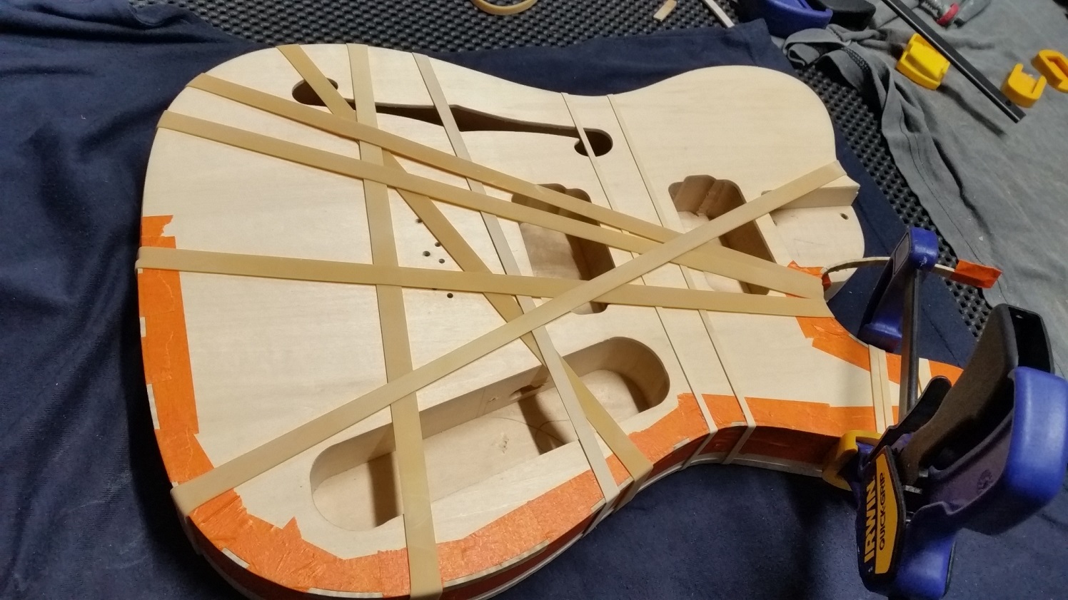

    Being aware of glue issues and am planning on using stains for the colouring, went the extra step of taping up both edges of the binding channel. The soaking of the maple pieces did cause some warping which meant some sanding, well filing, was needed on the mating faces. If you don't have a Shinto saw rasp, get one, they are awesome. Did break this piece during fitting up went back together well.
    And here goes
ID:	39794Click image for larger version.
    Looks a little like an EVH tribute a this point
