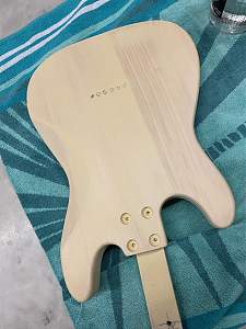

    a) the body doesn't quite fit under the drill press to use that to drill the string-throughs. I ended up using the drill press to drill a drilling guide nice and square, then used the supplied bridge to mark the top-side and drilled starter points to pick up the drill but and then went down about half-way. I followed that by drilling the 2 e strings right through the body, then checking the bridge lined up on the backside which it did! I then played the same game with starter holes, then clamped a straight edge to guid my drill-bit to make sure they're nice and straight... rinse and repeat on the back edge for the wider ferrule counter-sinks
    b) basswood is SUPER soft... lots of compression in the neck ferrules. I used the drill press to bore out the existing screw holes, using the depth stop for consistency, but they must have compressed another 3mm into the back of the body at tension! All good, tight neck achieved

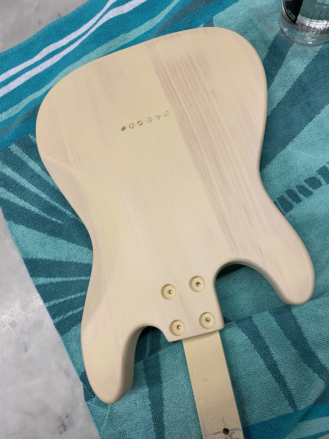

    A solid day on the sandpaper today to get the primer laid out. More great lessons learned:

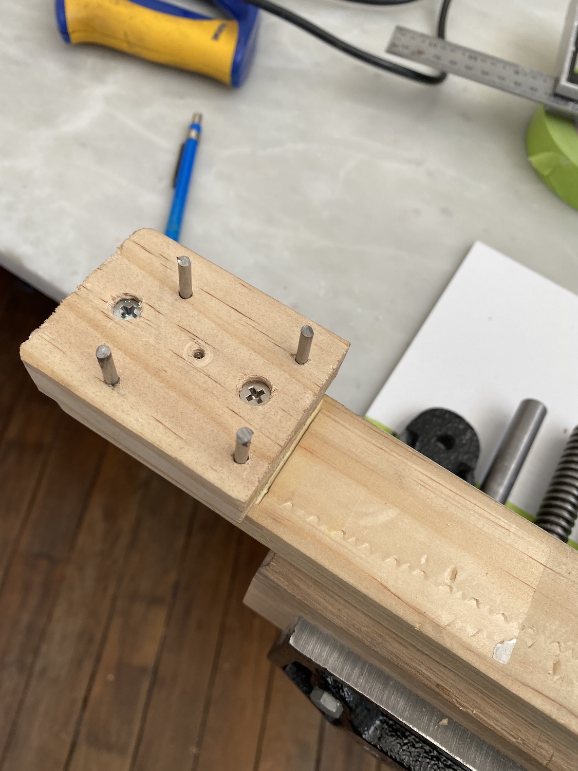

    a) There's actually a fair amount of time that you need to invest in making some basic tooling on your first build... Today's tool was the painting handle for the body. This is iteration 1 - I'll likely redo it with some 1 inch dowel or something that I can put in a jig down the line, but getting dimensions right to give me a bit of edge-over in the neck pocket for spraying and looking at a minimum impact, full back exposure design... photo's below. Basically a handle onto a block (roughly the size of the neck plate, and some studs that slide into the screw holes, then you can just punch a single screw into the middle of it all)
    b) When you're proud as punch of the sanding you've done and you've got a silky glass-like finish with 220 grit sandpaper, you're probably only half way there

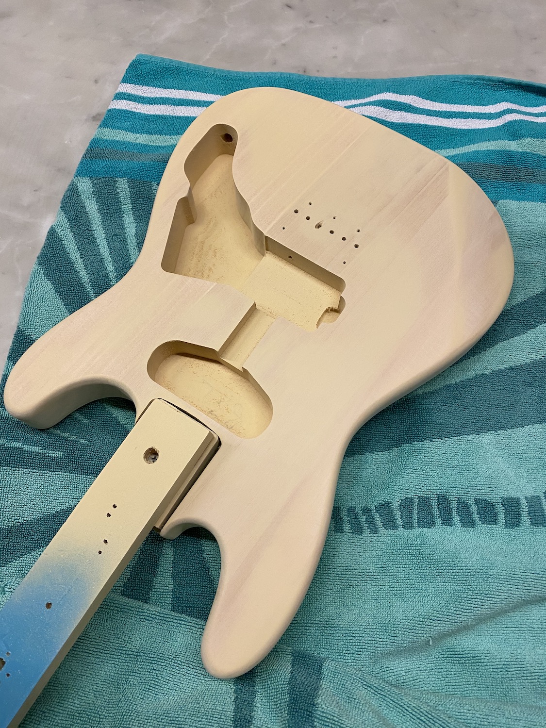

    c) the first hit of primer will very quickly expose all the sins of the world!
    For info, I did a full large can of the Septone primer filler from Supercheap Auto - 1 medium coat sanded back (220), then 3 fine coats ready to just lightly knock back (360 grit) and lay down the undercoat colour.
    I thought I'd done a stellar job with the sanding, but the primer quickly disproved that theory. I'd always planned to prime and sand and re-prime, but I was surprised at how much grain stood up and invisible marks jumped out once that primer hit.

    These are just the rough handle... a bit of tite bond and 2 screws to hold it all together

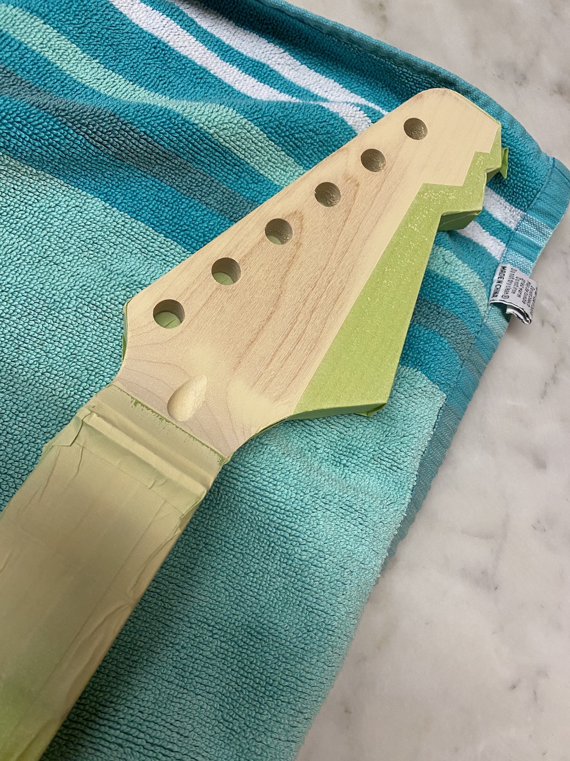

    Post primer and sand down, still shows some good low spots in the original sanding. Lighting detail on the headstock is masked off now - the face of the headstock will be the same as the guitar, with a natural lightning bolt per the customer's request (that would be my childrren)
