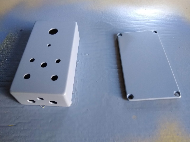

    I am still not fond of the pedal name, but that's not important right now. A little bit of progress today getting the enclosure drilled and primed. The new drilling templates I have made in Inkscape are working really well. As a result, these later enclosures are more accurate than the earlier builds this year where I was using generic templates off the internet.

    I will spray the green tomorrow and let it cure for a bit. I made the mistake once of assembling a pedal while the lacquer is still a bit soft. Marks everywhere.
