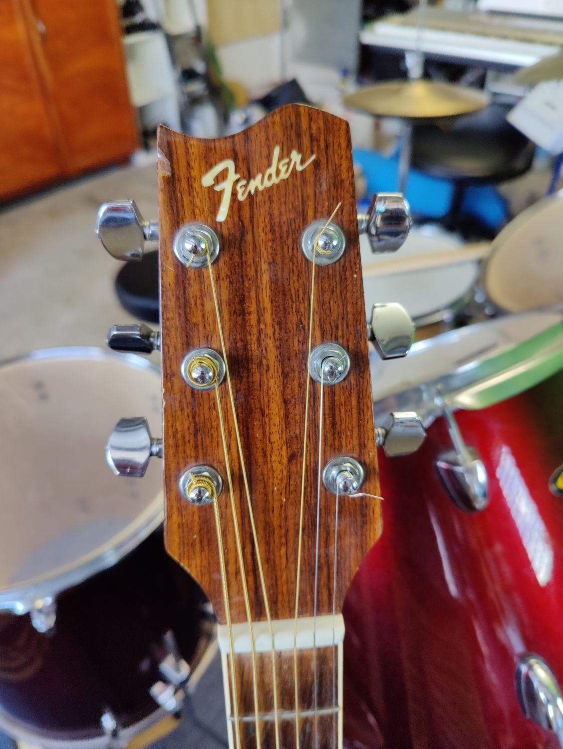

    Interesting how close the the Line6 is to one of the 3x3 headstocks that Fender developed for some of their MIJ Acoustics in the 80's. (Of course, the chip in the upper left corner is an "aftermarket" addition.

    .... I am not a fan of the prototype Tele headstock. I guess Fender weren't either ;-)
