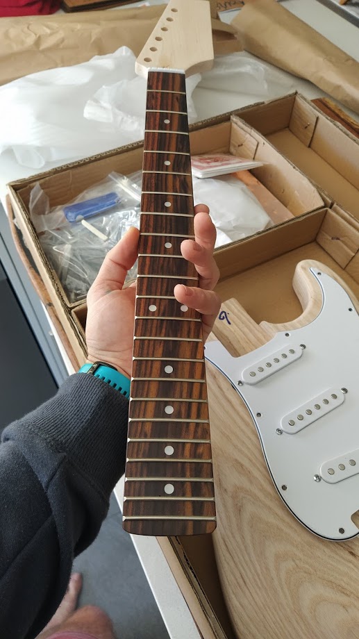

    Just got my first kit yesterday, GST-1 (american ash body, maple neck, jatoba fretboard)
    Love the grain in both the fretboard and the body, so planning on doing a stain/natural kind of look to showcase the grain.
    Just started doing the dry build, all seems sweet. 1 question though, how snug of a fit do we want the neck to be in the body. It is firm all the way around except for the "bridge end" of the heel.
    See attached photo.
    Should I be shaping that out a bit more to fit perfectly or is this gap the norm?
    Look forward to this build!
    Cheers
    Mitch

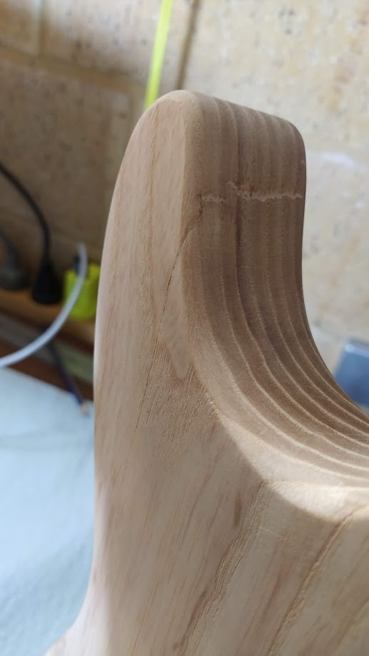

    Also, upon sanding I have noticed this large chip/split.
    It originally looked like it was just a machine mark but once i sanded through it turned out to be a pretty decent crack.
    Will wood filler cover this?
    Cheers
    Ouch. Ok so going by your above post you are planning a burst, so any repair will be covered which is good. Personally I would fill it with CA (superglue) first, then take up any other indent with filler.
    There are a number of ways to do a burst, some people get quite good results staining a the lighter colour and then blending in the darker colour from the edge. Otherwise an airbrush is a good idea. If you are handy with rattle cans' you could probably get a reasonable result as well. They do take a bit of practice to get right so I would have a go on some scrap wood or cheap pine to see what's going to work best for you.
    Personally I wouldn't be happy with that at all. There's a danger that any knock on that horn will open the crack right up.
    I'd email Adam and see what he suggests as it's not just cosmetic. That's right through the wood. I'd be after a new body.
    Otherwise it would be safest to knock/break that corner off and stick it back on properly. It seems drastic but it is the right way to fix it, same as if it was a neck break.
    I think I would as well looks like a fault in the wood,
    If you want to go down the burst road you really need a spray gun or very least an airbrush to do it right, it's pretty easy to make a pigs ear out of it get the body changed 1st
