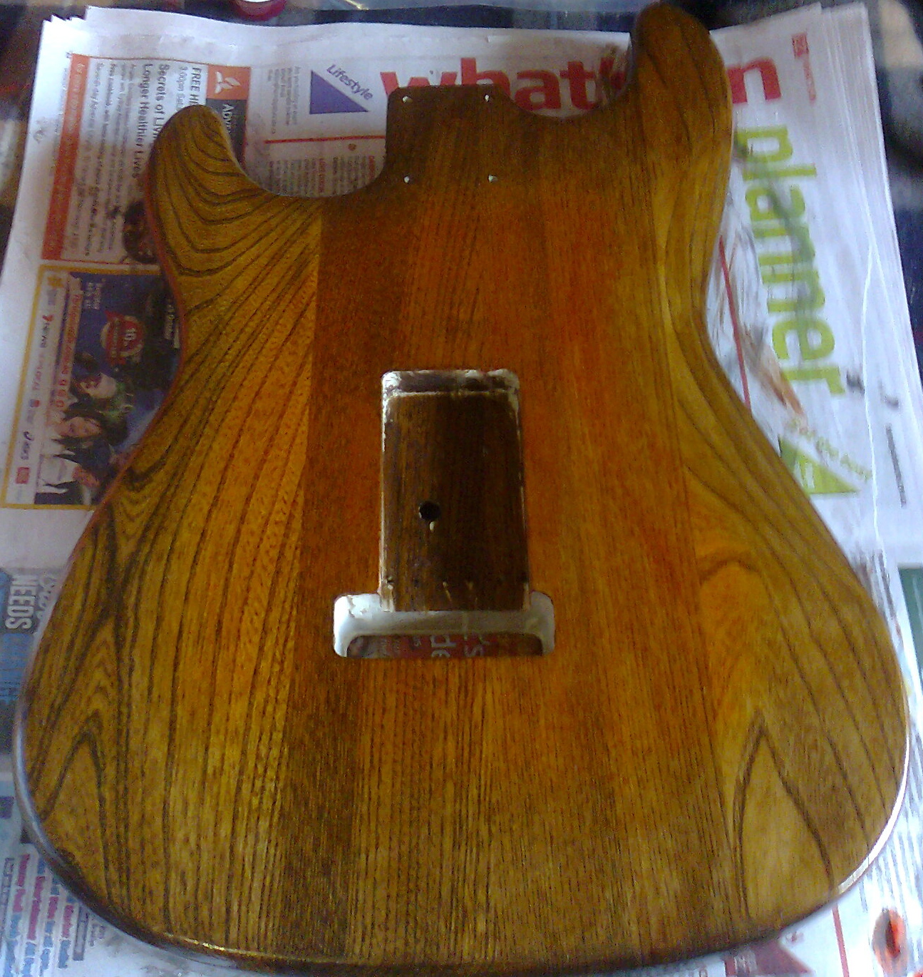

    The weather is starting to warm up and things are starting to move on this beastie! I've taken a punt and tried my first burst. Just the back so far. Outback Sunset and Black Stump. The picture is just after popping the grain with some of the black stump and one base coat session. I'll just have to see how the colours settle as they dry.

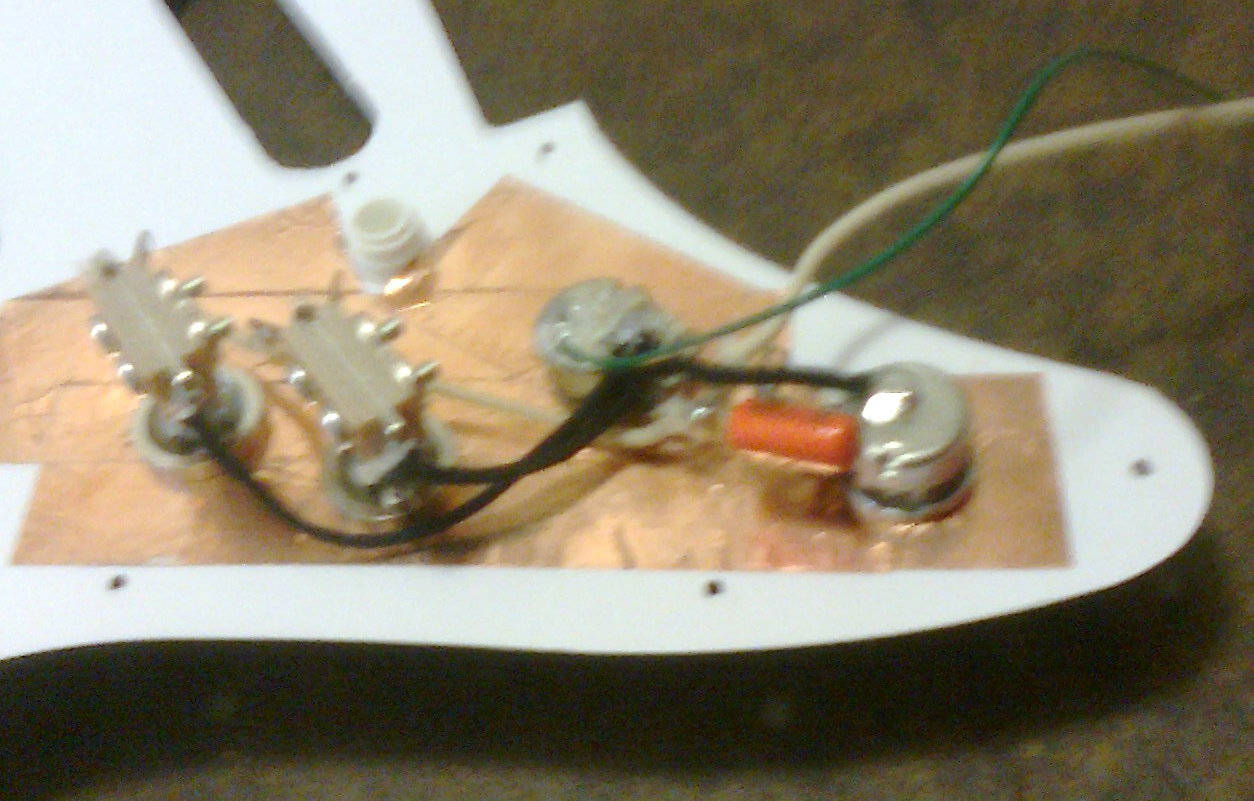

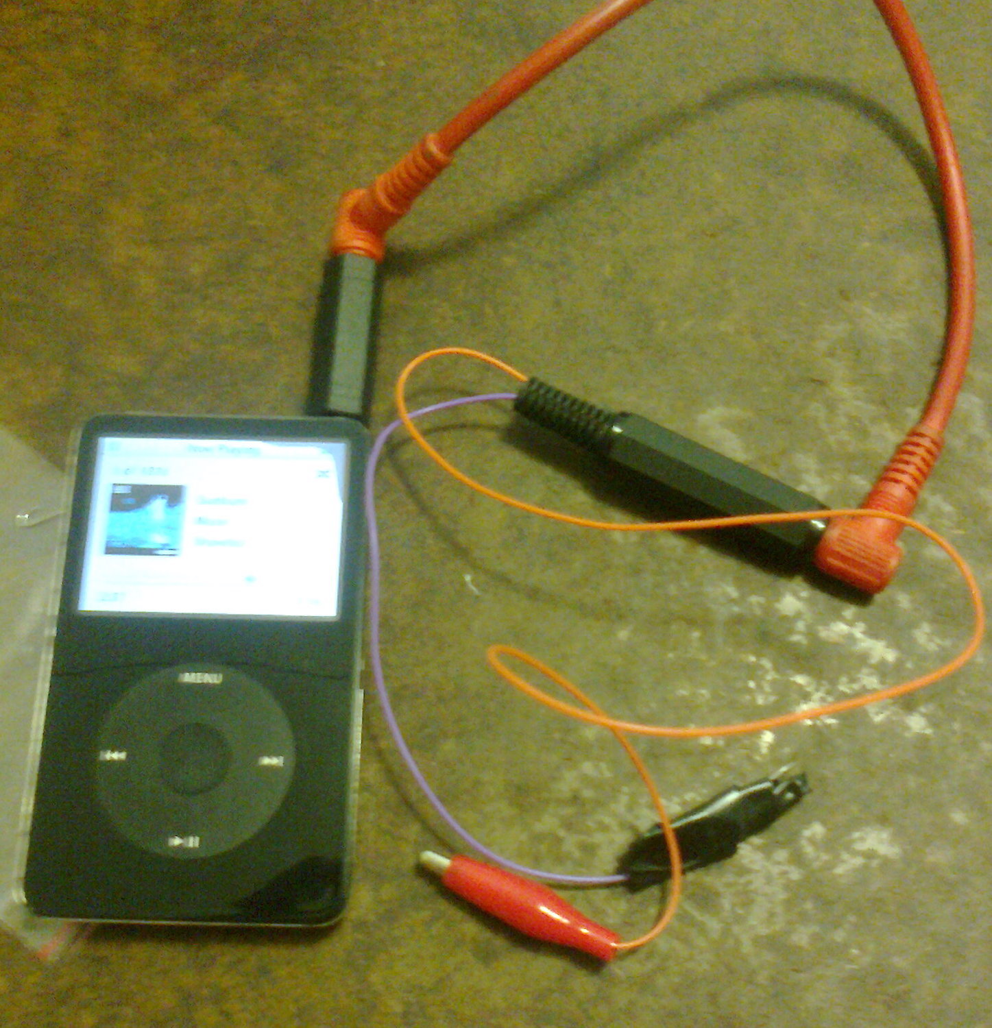

    I was hoping to get a lot done while I was off this week, but this weather is not useful for much at all, so I've done the wiring instead. Included is a photo of the test probe. If you haven't made yourself one of these yet it's worth it, especially if you have questionable soldering abilities (like me). (Wiring is based on Gibson's Explorer III circuit.)

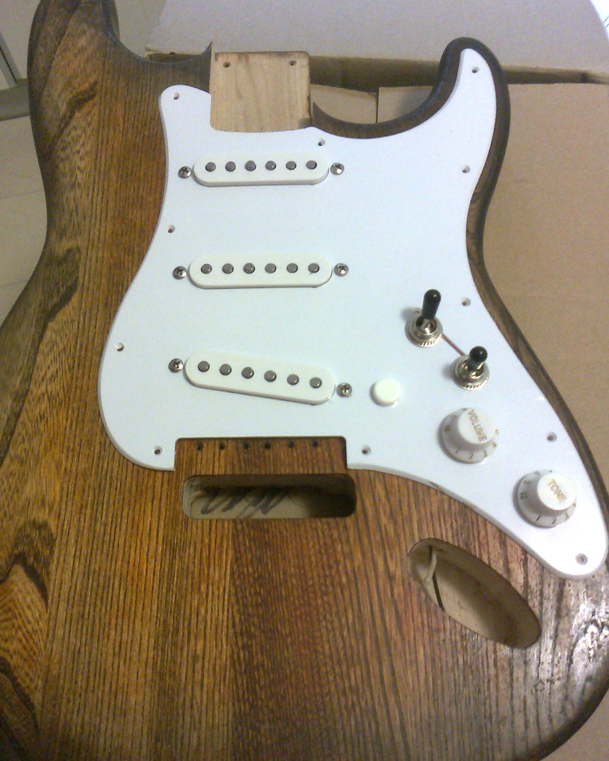

    With the Tonerider Surfaris installed. The top left switch selects neck &/or bridge pickup. The right switch selects left switch &/or middle pickup. Between these two switches you get every possible pickup combination, including all three and neck & bridge only - the two combinations standard Strat switching doesn't have.

    Different wiring approach Fretty and I like it. With the veneeer depends a bit on the timber I suppose. I have only done veneers with maple and it can be a pain for splitting. I find art/stanley knife cuts cleanest but I always cut a bigger piece than headstock with one straight edge for the nut/fretboard end. Once glued and unclamped I turn headstock over and trim with artknife and then cleanup with wood files.
