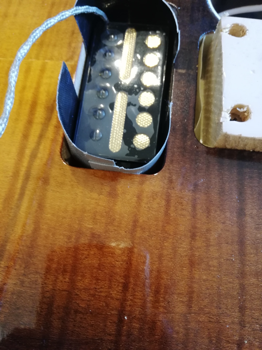

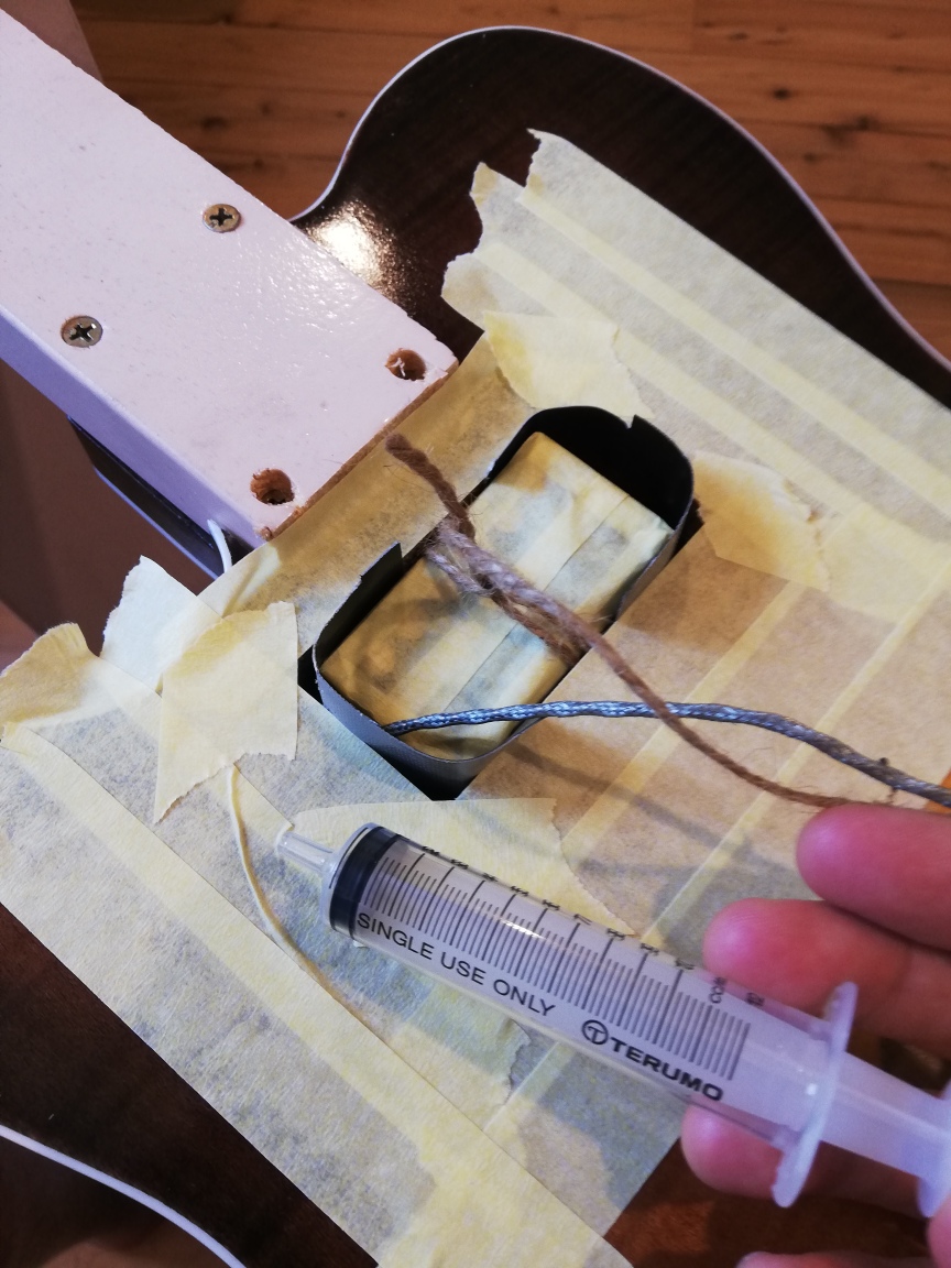

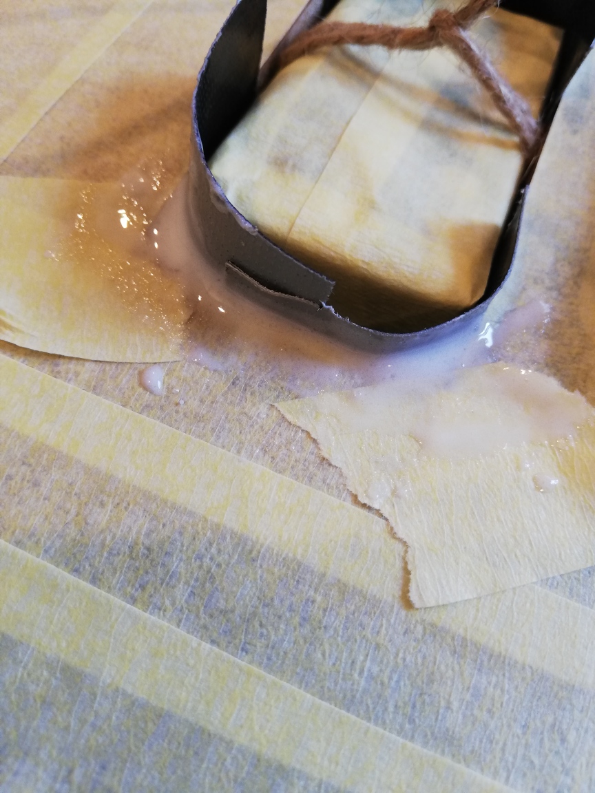

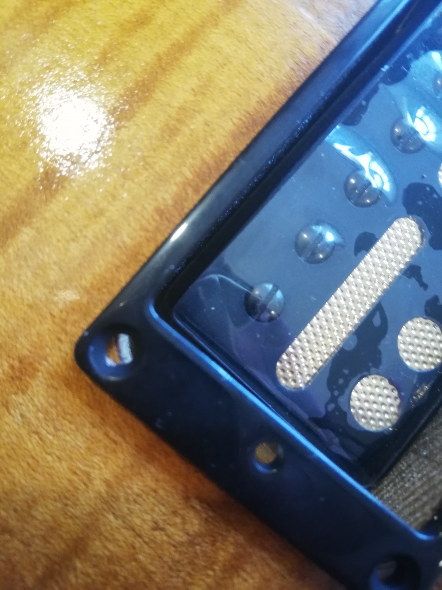

    When the screw holes of your pickup ring go into nothing!!
    Today Sunbird had an appointment with Doktor Rolf, applying some epoxy to create "something" to bite into. The only thing is... I have to lift the pick-up out before the Epoxy goes hard, but leave the pickup in there long enough for it to set :-). Makes for some excitement again.
    Still not dreading the decision to get rid of the pickguard.
    If all goes well, the end of next week we can start sanding and polishing
