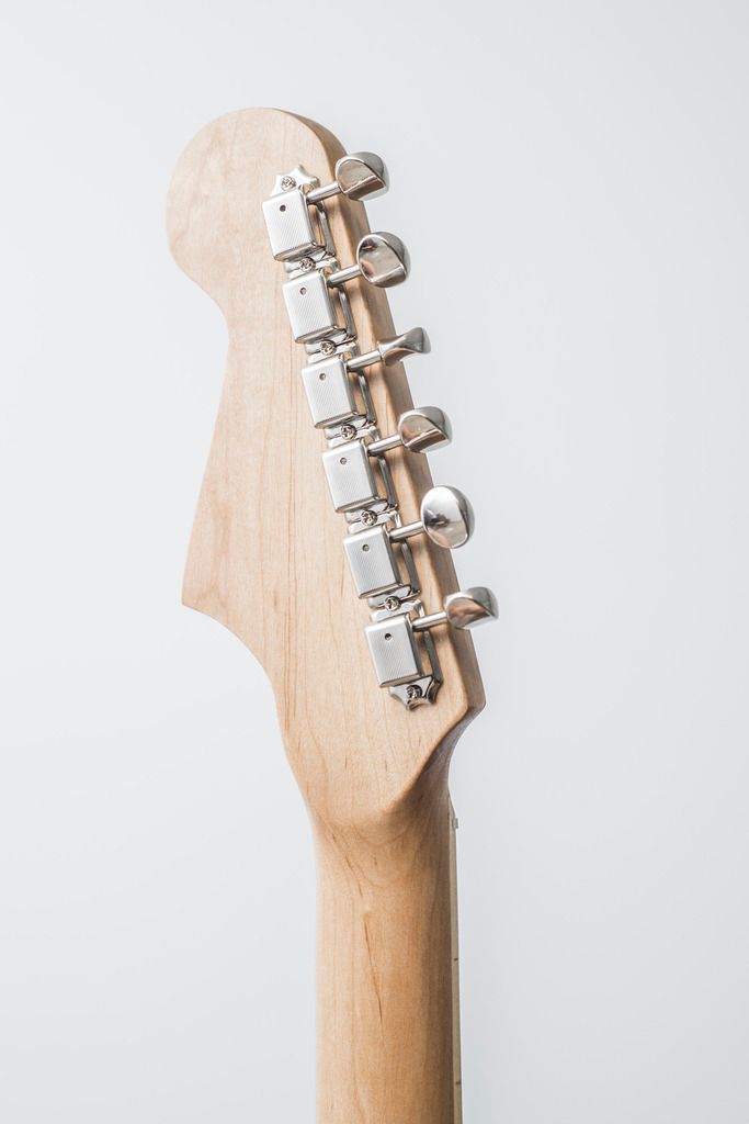

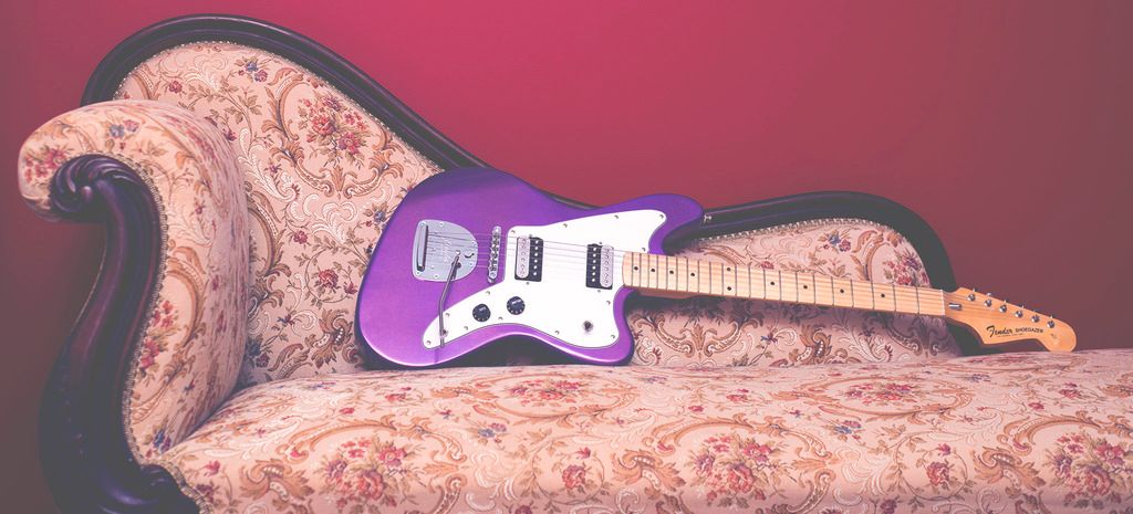

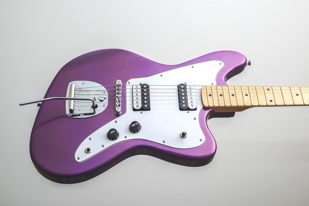

    Wooo! all done pretty stoked on how this turned out.
    If you haven't been following the build, its a JM-1 kit with the maple neck from an ST-1M kit, the bridge is from a Pitbull kit as well.... the rest is not.
    the mod list is pretty heavy... the body was plugged and re-routed for the new pickguard layout and the original trem cavity filled as well. I then added the TOM bridge and routed out the body for the floating trem.
    The body was then sanded and primed and shot with gloss white. the top coat is rattlebomb 'Str8 Purplin' its a metallic/pearlescent all in one.
    I plugged/redrilled the headstock and put a maple veneer on to hide the plugs and upgraded to some Gotoh vintage inline tuners and changed the nut. I also opened up the trussrod hole to fit in a 70's style bullet... no way I'd put a truss rod cover on a F style neck so I though this would be a cool little finish.... first time making decals as well.

    cheers man, it sounds and plays really nice... the tone nob is a push/pull pot and the humbuckers are coil tapped so its got a fat humbucker tone and well as a sweet single coil sound at my fingertips.

    Thanks so much man, yeah I seen your threads asking about the JM... if there's anything you want to ask by all means let me know. I was thinking bout you build actually... I THINK you could drop a standard strat trem in and with some minor routing get a similar pickguard combo (its basically a Fender blacktop Jazzmaster) in it.
