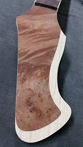

    Well, after some scraping, sanding and swearing (lots of swearing) the first veneering attempt has been removed. Might need to have some Turkey 101 on hand for the next attempt.
    On a positive, have shaped and glued the veneer to the HS. Used the tape and super glue trick to stick the veneer to the caul I made and sanded it to shape, carefully, then used a putty knife to separate the pieces. Then used painters tape to mark the position for it on the HS, thought that if I used pencil to mark the outline it could be a problem to get rid of the marks after the veneer is on. Seemed to work well. Will look a bit strange if I don't get the body done as well.

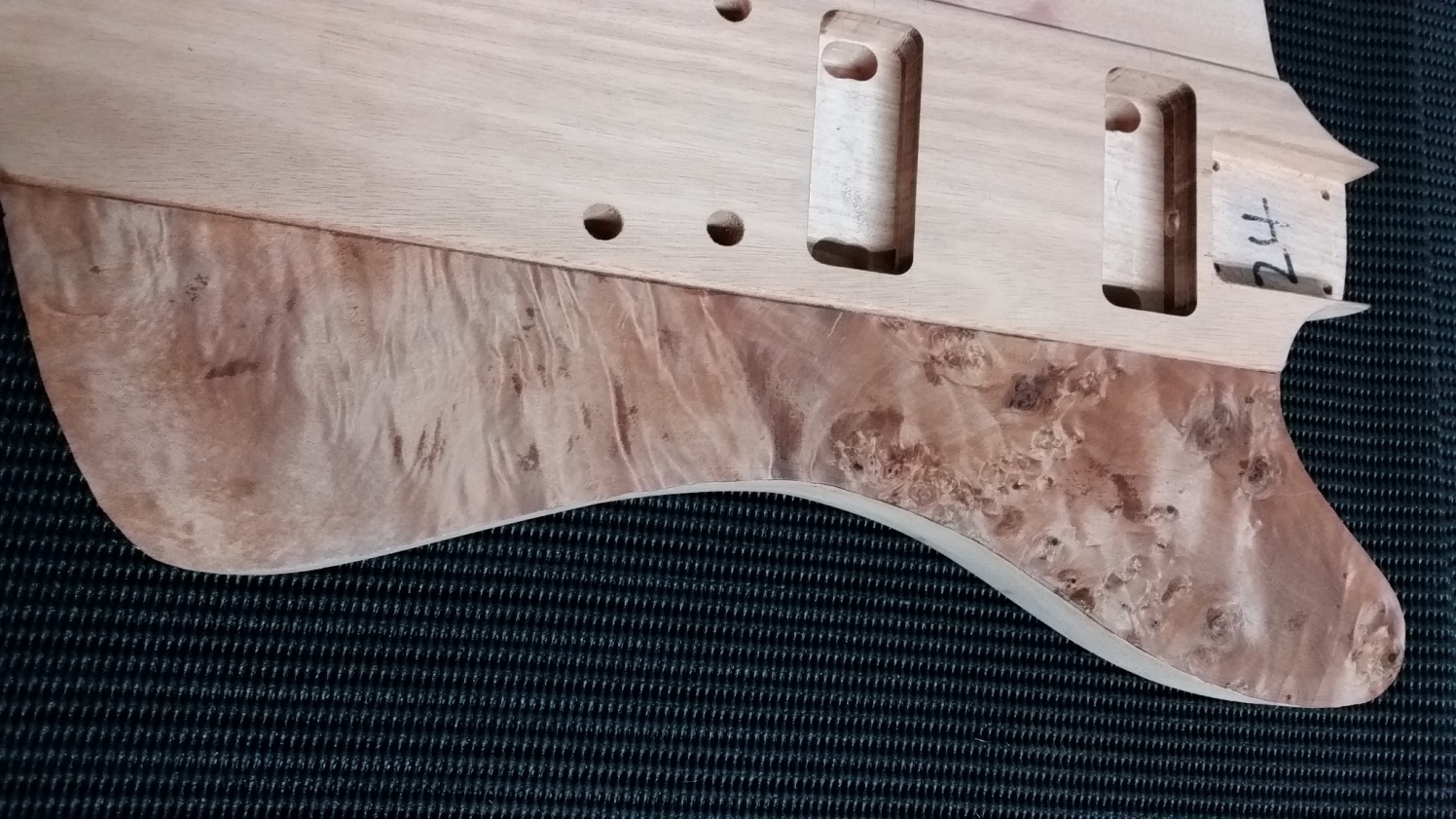

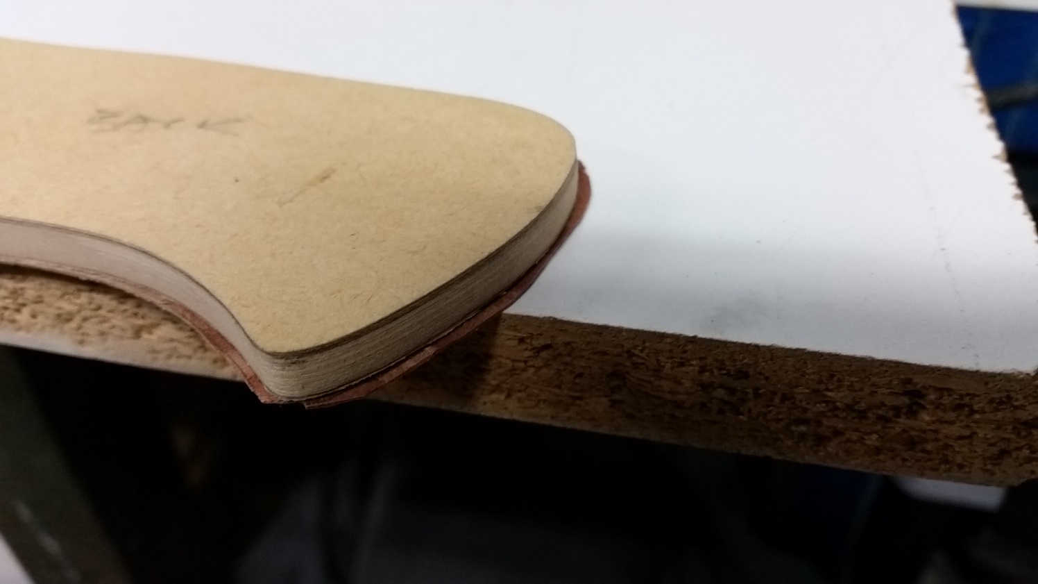

    More adventures in applying veneer. Got hold of some hide glue and had a go at the control side of the body. Trimmed the straight edge back to straight and taped into position. Applied the hide glue, lay the veneer in place, slid into the vac bag and used the vac bag to pull the veneer flat. Then a sheet of melamine on top, old socket set and bbq gas bottle for weight and left it for an hour and a half.
    Took it out of the bag and the mid section wasn't quite flat onto the body. A layer of wax paper, some timber and clamped it all down. Left that overnight and looks to have worked.
    Made a mess with the glue, cleaned up most with a damp cloth and what is left can get rid of with goof-off. Not sure if I need to do anything about the glue that came through the burls and parts of the flamed section. The burls probably won't be an issue, just where the flames are might have dark marks stand out when the poly goes on. The glue is still a bit tacky, will try to clean it up a bit more in a day or two.
