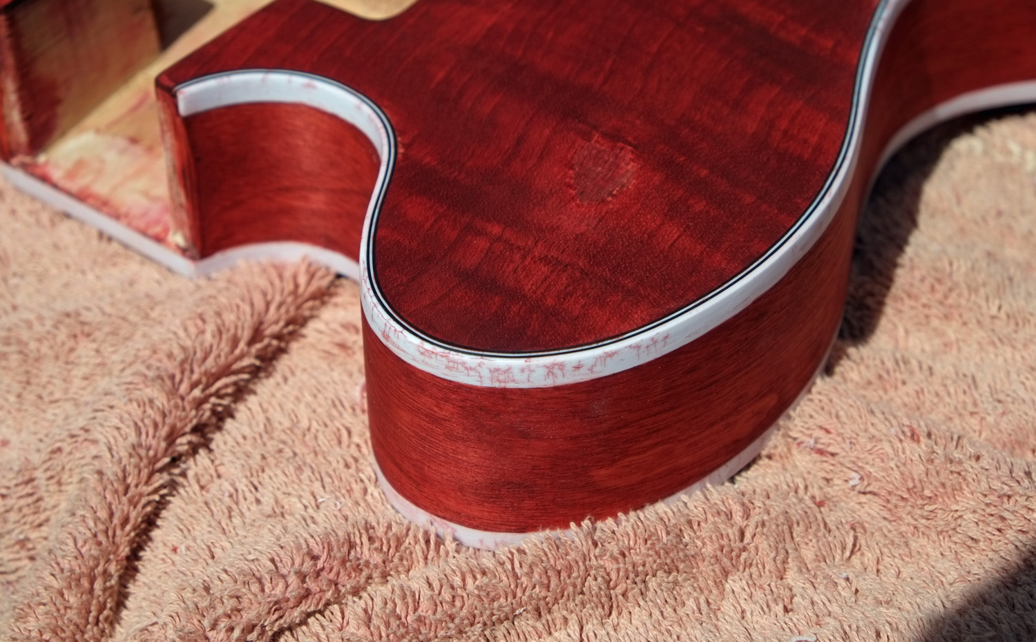

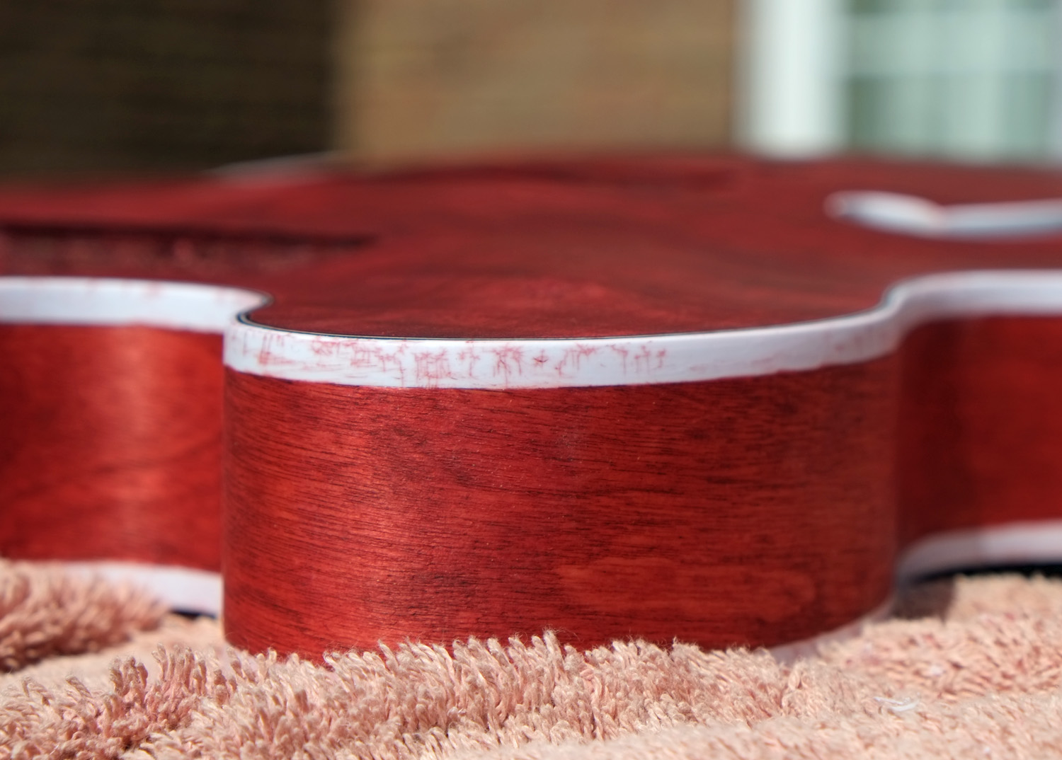

    Well, the binding is all scraped back, but the consequences of using coarse sandpaper to get the worst of the Tru-Oil off have come back to bite me on the binding. It's made deep scratch marks that have absorbed the stain. Maybe the spirit-based stain is more penetrating than the water based-stain.
Name:	Stained binding.jpg
    It's either that or I've discovered a secret message in Chinese from the builder hidden under the outer layer of the plastic.
    Some of the marks I've been able to scrape away. I've tried using metho on them and it's helped a little but not a huge amount. And it was getting too hot to do much or think clearly. We've had three days in a row of cloudless skies and temperatures in the upper 20s - over 28°C today. Which is a lot, especially when you're out sitting in the sun trying to make some vitamin D (and a week ago it was down to 1°C at night).
    So I'm not sure what to do with it at the moment. I'm tempted to try masking around the binding and painting it, though I'll probably try some other solvents first. You may have noticed in the top picture that I've managed to scrape away at the glue layer in the sand-through patch and the ply beneath had absorbed the stain, so it's looking better than it was, though it's far from perfect.
