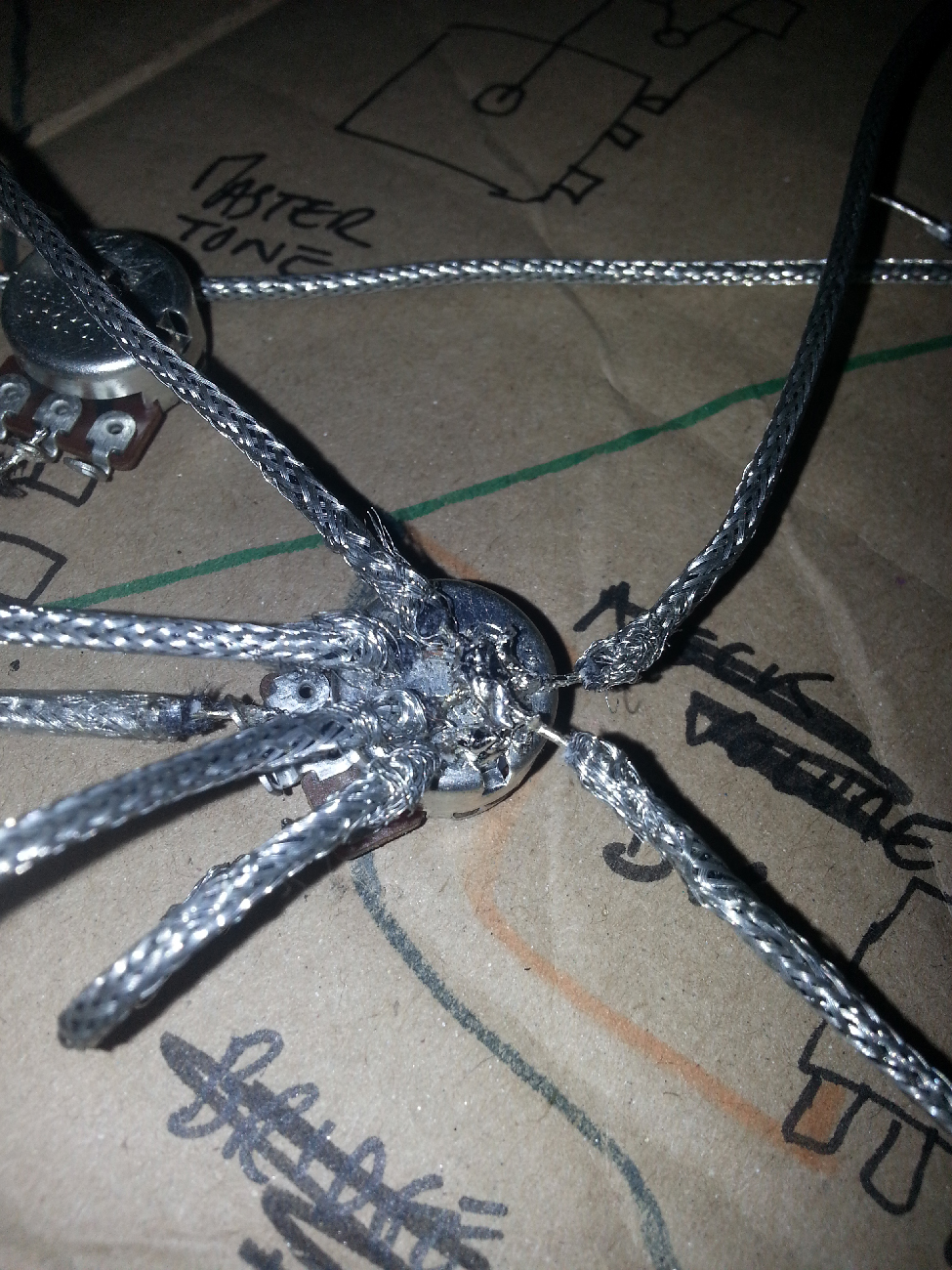

    I however need some advice on my soldering: I am worried that the way I have approach the soldering on the bridge volume pot might be a little bit "off". Should each wire make direct contact with the pot or is the way I have done it OK? It looks a little cramped and I am not sure whether this is ok or not?

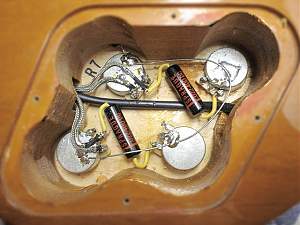

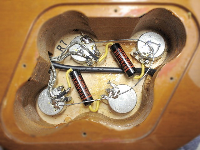

    With braided wire you want the inner core to carry your 'hot' and the outer braid to be the 'ground', that way your signal is shielded from noise and you have hot and ground in one wire. For example, to connect your output jack the inner core would connect to the 'hot' lug of the jack and the braid would connect to the jack's 'ground' lug. The other end of the wire would then have the inner core connect the 'hot' output lug of the volume pot (or switch etc.) and the braid would connect to the common ground point like the back of the pot.
    It's important to push back and offset the braid from the exposed end of the inner core on any of your 'hot' wires, otherwise the braid could become 'hot' too from touching it and can then short against any conductor it touches... other braid, pots, shielding, switches etc. causing all sorts of headaches. Heatshrink tubing can also help prevent any shorts between the braid and exposed inner core.
    Edit: This is a nice clean example of where the braid is soldered to the back of the pot as the 'ground' and the 'hot' inner core connects to the pot's lug. It's not a hollow body, but you get the idea.

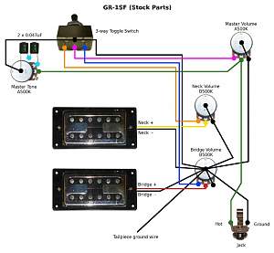

    Hi Weirdbits,
    I am a little unsure as to what would be defined as hot and ground in the following diagram.
    It looks like I might have to start from scratch. Which is ok as I kinda anticipated that the wiring would be a little tricky.
    I will see if I can do a diagram with the way I understand your great feedback and see if I am correct
