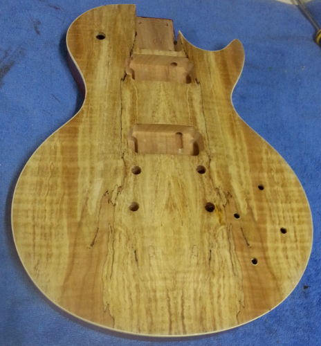

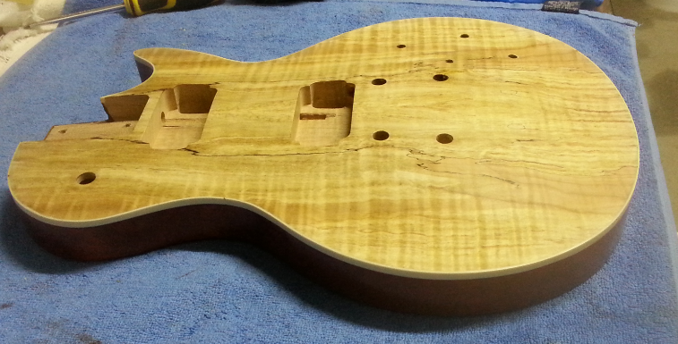

    Another update after the first clear coat on the spalt:

  7. #67
    Jan 2017
    British Columbia, Canada
    239
    Your spalted LP is looking pretty great so far. I'm hoping my upcoming spalted FV will look that good when I get to it in a few months. It's great to see how everybody is handling the finishing on these tops. Keep up the good work.
  8. #68
    Quote Originally Posted by CascadiaGuitarGeek View Post
    Thanks CascadiaGuitarGeek, I did wan't to colour stain it but was a bit worried because the spalted maple is paper thin. If I made a mistake it would be hard to undo so I decided to stay simple and keep it clear with the poly which highlights the natural grain.
    The one Zandit75 did inspired me to do the same because that one looks amazing. Check it out if you haven't seen it yet.
    Alkay.
