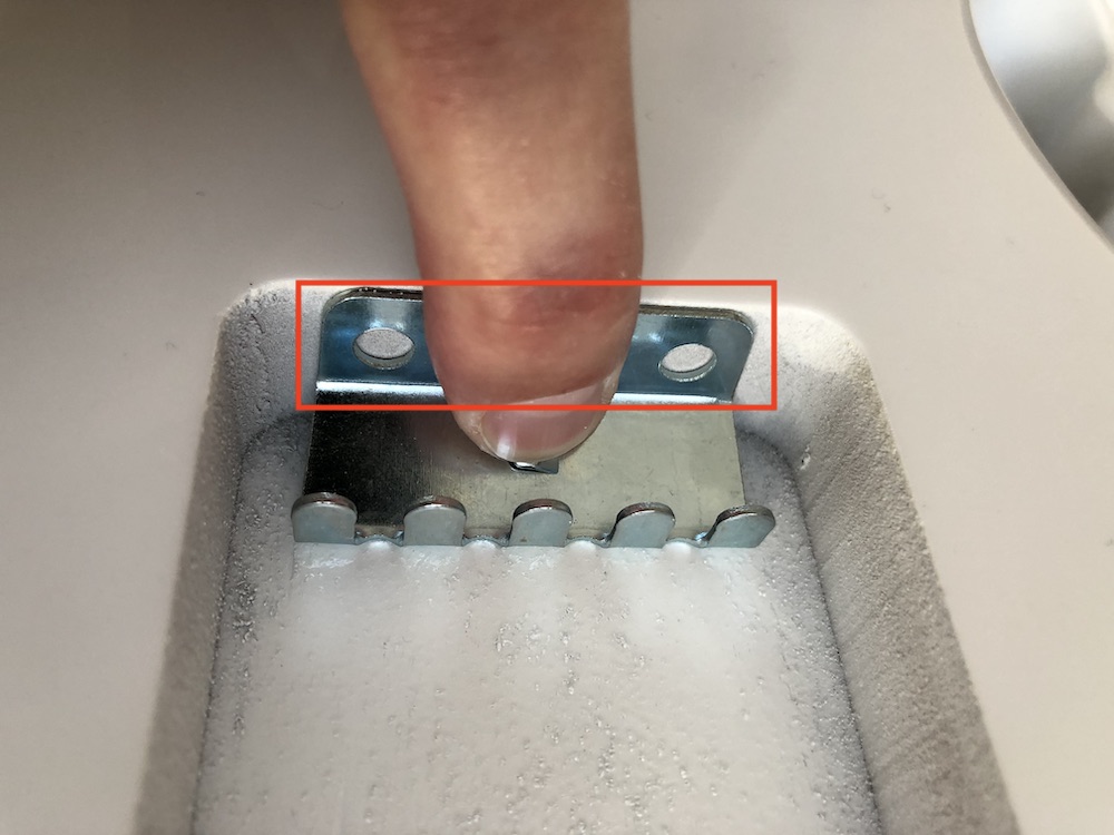

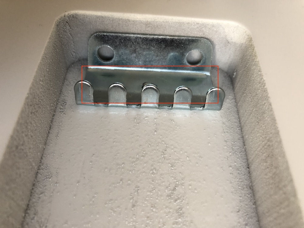

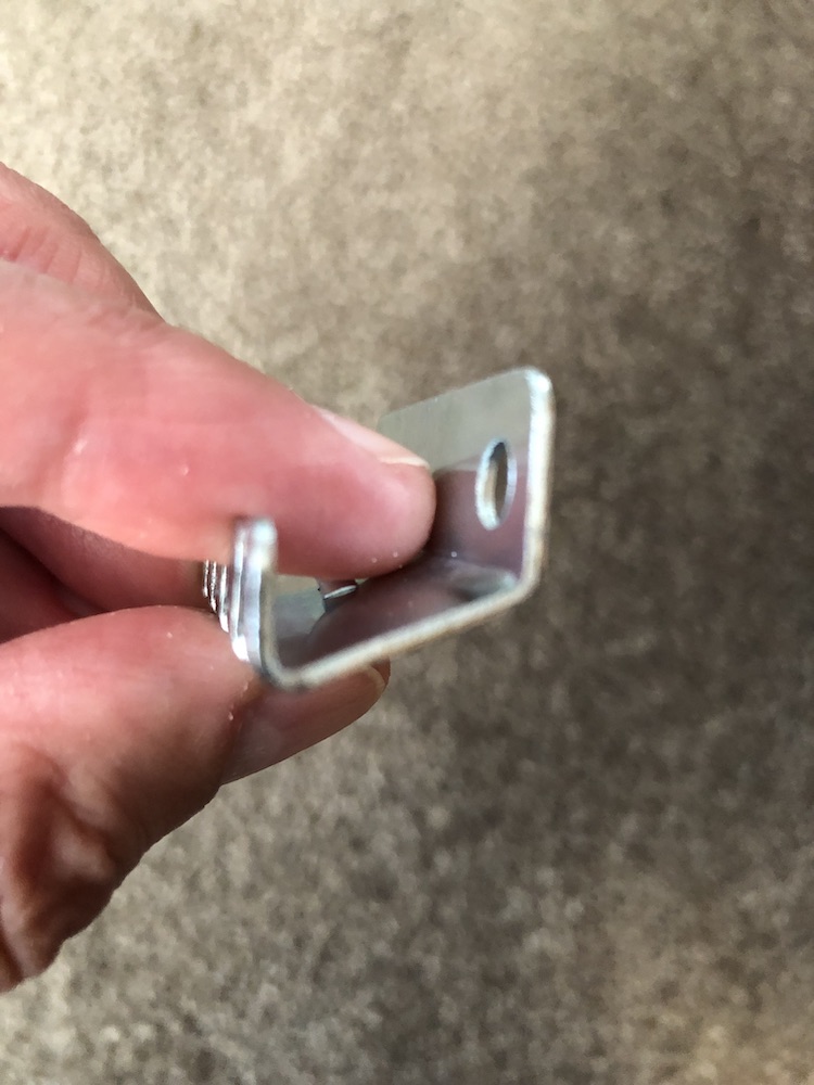

    Just after some advice on installing the spring claw.
    1. Do i install with the screw hole side flat against the wall of the cavity? or
    2. Do in stall with the bottom flat against the bottom of the cavity? or
    3. It makes no difference?
    Also should the screws go in straight / flat or on a slight downward angle?

    You want to get the screws in as flat as you can. If possible, pre drill.
    the claw isn’t designed to sit hard up against the wall, it should sit on the rear of the screw heads.
    you might have as much as 15 mm of screw exposed once it’s all set up and then you adjust as needed against the string tension to get the trek level.

    Thanks FW. Yeah i only put up against the wall to show the difference of where i would have to screw / drill. So is it best to just centre the holes in both directions and go from there? At least then the claw shouldn't be on such an angle as it pops through the top of the cavity?

    Correct,, that’s how I’ve done it on mine and it sits nicely below the cover plate, which I also recessed.

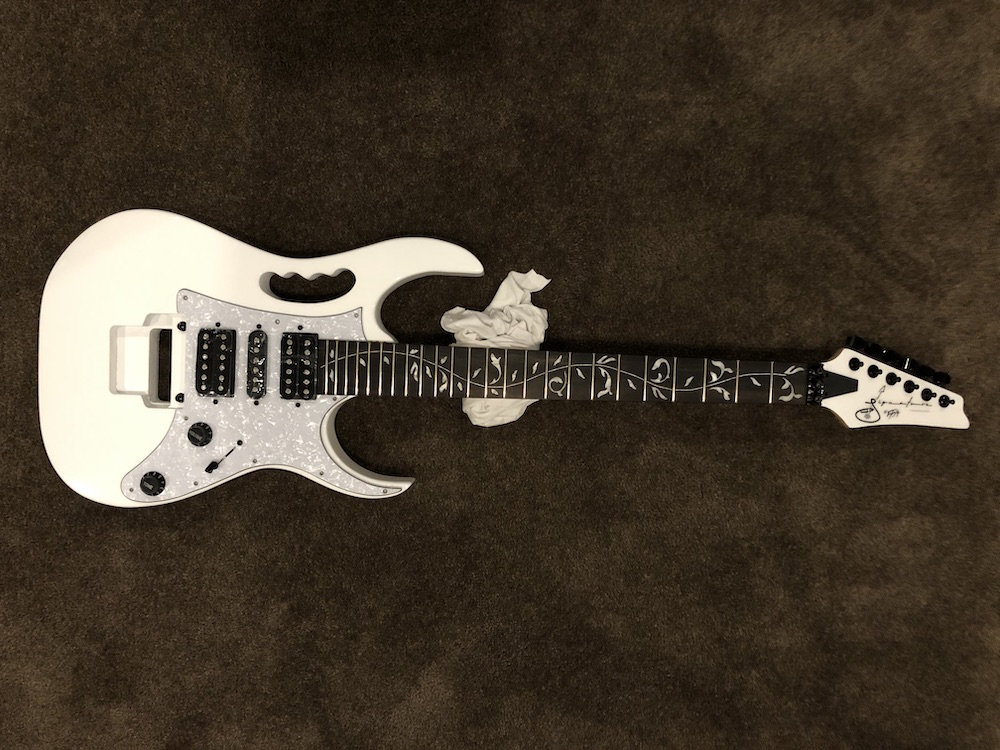

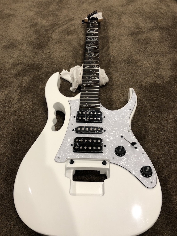

    Thought i might add a sneak peak at how its coming together...with next steps around fret levelling and cleaning etc before putting scratch plate back on and soldering. Bridge claw installed so just need to sit the bridge in when ready to string. Might put a string retainer in too.

    You’ll really want the string retainer bar, it helps keep tuning relatively stable. Unless you are dive bombing like a Stuka Squadron!
